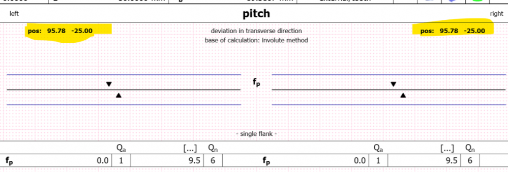

[Ma...] Posted March 13, 2025 Share Posted March 13, 2025 Is it possible to get the MOW measurement height on the report? I've noticed if I turn on fp Fp or fu it will appear at the top of the Pitch graph, but I don't want these displayed. Link to comment Share on other sites More sharing options...
[Ro...] Posted March 14, 2025 Share Posted March 14, 2025 Hi Marc, you mean the yellow marked information should disappear? Not possible at the moment but I will take that point with me to consider for a future version of GEAR PRO. Link to comment Share on other sites More sharing options...
[Ma...] Posted March 14, 2025 Author Share Posted March 14, 2025 Hello Roman, Correct. I would like to see that displayed even when only evaluating MdK. It does not display unless I select fp Fp or fu evaluations. Thank you for considering this. Link to comment Share on other sites More sharing options...
