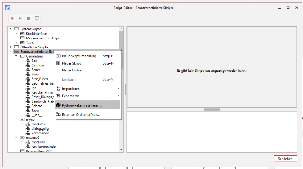

[Na...] Posted March 19, 2025 Share Posted March 19, 2025 Hello Radosław, in Inspect 2022 you can install python packages with a right click: A quick search showed up "pdfmerge", but I have no experience with this package. Nanno 1 Link to comment Share on other sites More sharing options...
[Ra...] Posted March 19, 2025 Author Share Posted March 19, 2025 Hello Nanno, Thanks for the help, there is indeed such an option. When I run the script to install the package, I have to provide the path to the package that I want to install and that's where I have a problem. I don't have an internet connection on this computer. I have to download the package from the net and install it from the local disk, does GOM have the "pypdf" package somewhere? Link to comment Share on other sites More sharing options...

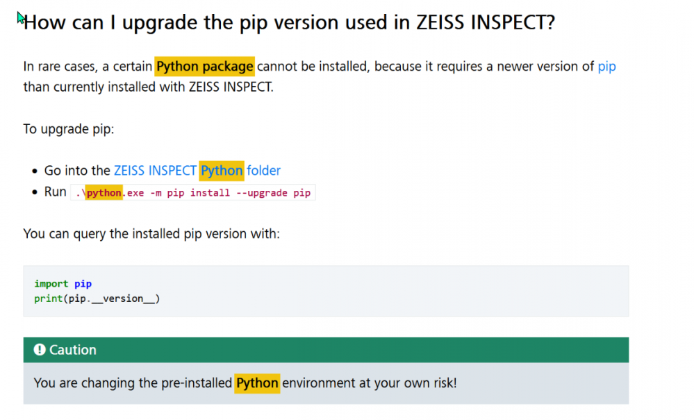

[De...] Posted March 20, 2025 Share Posted March 20, 2025 you'll have to download the python wheel then install it with the "local" setting , Not sure when they added this functionality, in 2020, and 2022 you might have to go use the old method: (not sure where documentation is at, but you can ref 2023 to figure it out?) https://zeiss.github.io/zeiss-inspect-app-api/2023/howtos/faq/faq.html#where-is-the-python-installation-used-by-zeiss-inspect-located if your wheel file is located in the current directory, you can run: pip install your_library.whl 1 Link to comment Share on other sites More sharing options...
[Ra...] Posted March 25, 2025 Author Share Posted March 25, 2025 (edited) Hello Devon, Thanks for your help, everything is correct, there is an option to install python locally and I don't have to do the installation using the old method. I will try at the end of the week. Best regards R.D Edited March 25, 2025 Link to comment Share on other sites More sharing options...
