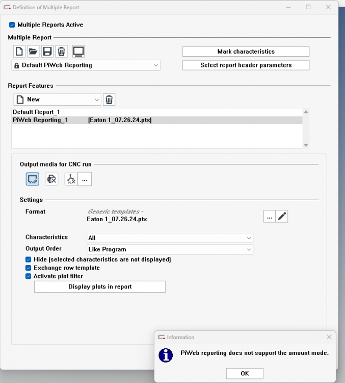

[Ri...] Posted March 17, 2025 Share Posted March 17, 2025 What does this message mean? How do I fix it? It's a PiWeb ptx file we use on everything; it seems to have an issue with one program. Link to comment Share on other sites More sharing options...

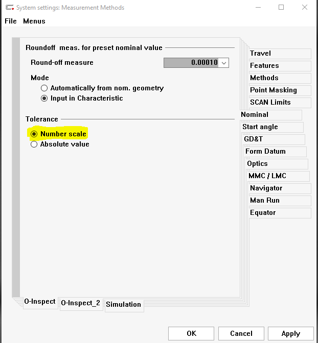

[An...] Posted March 17, 2025 Share Posted March 17, 2025 (edited) If I remember correctly, this is referring to the tolerances being reported as an absolute value vs a "typical" ± tolerance. Change this setting from Absolute Value to Number Scale, under Extras -> Settings -> Measurement -> Nominal Edited March 17, 2025 Link to comment Share on other sites More sharing options...

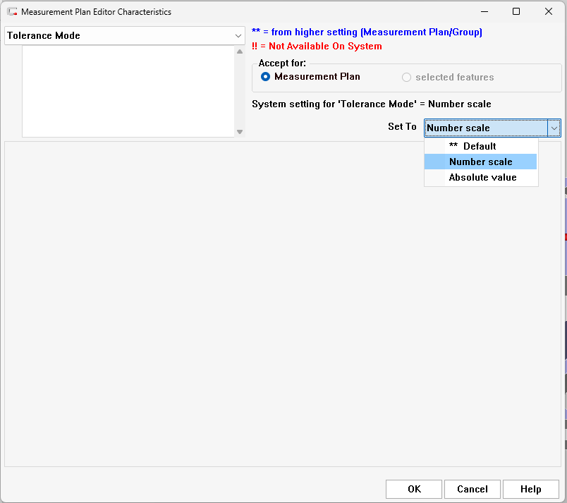

[Ma...] Posted March 17, 2025 Share Posted March 17, 2025 As shown PiWeb only supports Number scale,if you use "amount mode" and you have uneven tolerances (for example -0,1/+0,2 and a negative nominal value, PiWeb will switch the tolerances (opposite to the drawing) This can also be edited for each inspection: Best Regards Marcel Link to comment Share on other sites More sharing options...
[Ri...] Posted March 17, 2025 Author Share Posted March 17, 2025 (edited) Now I have to figure out who is messing with settings in programs. 🤔 Marcel is correct, that solved the PiWeb message. Edited March 17, 2025 Link to comment Share on other sites More sharing options...
