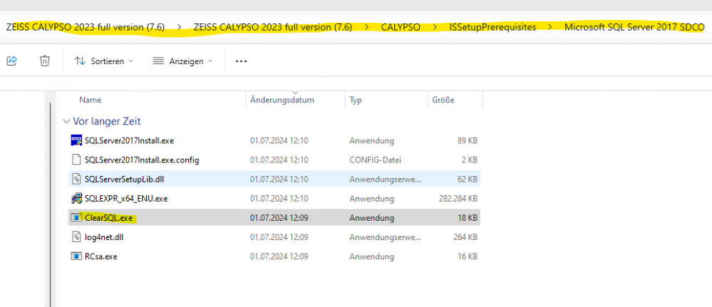

[Ma...] Posted March 18, 2025 Share Posted March 18, 2025 Good Morning, within the Installer of CALYPSO 2017-2023 you find a ClearSQL.exe, the folder can vary with each version but you find it within the SQL Installation files. Just run the ClearSQL.exe and it will cut the connection to the CALYPSO Database. For example CALYPSO 2023: Best Regards Marcel Link to comment Share on other sites More sharing options...
[FL...] Posted March 18, 2025 Author Share Posted March 18, 2025 Please sign in to view this quote. Marcel, I dont see ClearSQL.exe. The only thing i see is the Install.exe Link to comment Share on other sites More sharing options...
[Ma...] Posted March 18, 2025 Share Posted March 18, 2025 Hi FLTRXS, then you probably have CALYPSO 2024, its not included in this Version. I try to attach it in here but its an .exe file which might not work. Best Regards Marcel ClearSQL.exe Link to comment Share on other sites More sharing options...

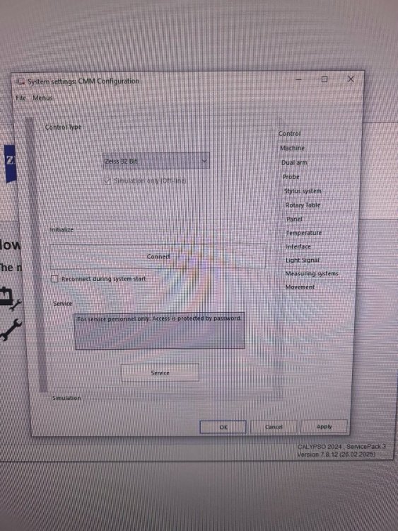

[FL...] Posted March 19, 2025 Author Share Posted March 19, 2025 Please sign in to view this quote. Jeff, I deleted the config file and restarted calypso, everything is new. How can I get the machine out of simulation, see pic_1. Once I configure the machine, probe and qualify master probe will it then get out of simulation? Link to comment Share on other sites More sharing options...

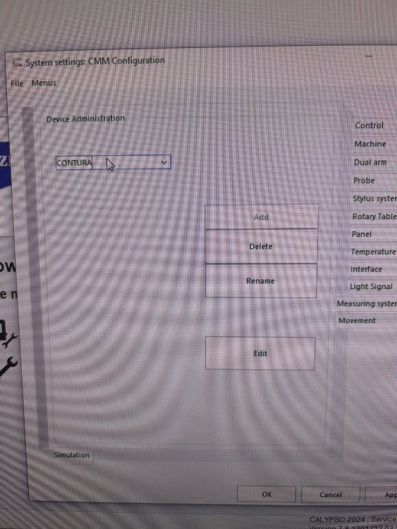

[FL...] Posted March 19, 2025 Author Share Posted March 19, 2025 Please sign in to view this quote. what it looked like before, see piuc_2 Link to comment Share on other sites More sharing options...

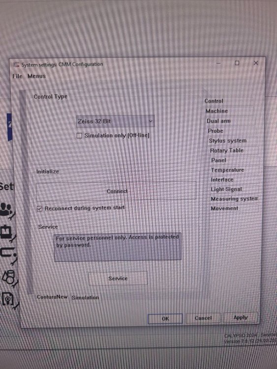

[Lu...] Posted March 19, 2025 Share Posted March 19, 2025 Hello, You'll need to create a new machine tab. This will allow you to uncheck the simulation only option and connect to your machine. KNOWLEDGE BASE ARTICLE Link to comment Share on other sites More sharing options...
[FL...] Posted March 19, 2025 Author Share Posted March 19, 2025 Please sign in to view this quote. Thanks for the info. I tried following it, but the ADD button is greyed out Link to comment Share on other sites More sharing options...
[Lu...] Posted March 19, 2025 Share Posted March 19, 2025 Please sign in to view this quote. Hit the ENTER key. Link to comment Share on other sites More sharing options...
