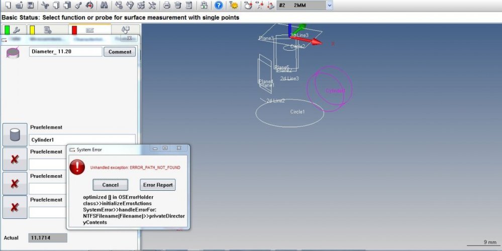

[so...] Posted March 17, 2025 Share Posted March 17, 2025 Link to comment Share on other sites More sharing options...
[Jo...] Posted March 18, 2025 Share Posted March 18, 2025 Align nominals to drawing. Link to comment Share on other sites More sharing options...
[so...] Posted March 18, 2025 Author Share Posted March 18, 2025 Please sign in to view this quote. Manual touch point also not work and not show any tolerance. Link to comment Share on other sites More sharing options...
[Ri...] Posted March 18, 2025 Share Posted March 18, 2025 Click on "error Report", post the information so we can see what path may be affected. Link to comment Share on other sites More sharing options...
[Da...] Posted March 18, 2025 Share Posted March 18, 2025 ERROR_PATH_NOT_FOUND & NTFSFilename looks like a Windows/IT problem. Link to comment Share on other sites More sharing options...
