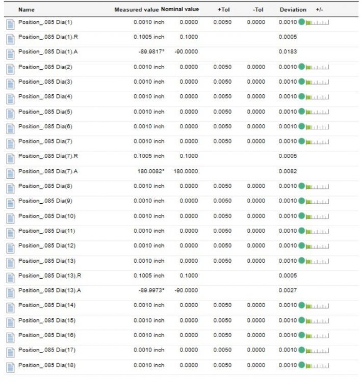

[To...] Posted March 21, 2025 Share Posted March 21, 2025 (edited) Calypso 2023 (7.6.04) Top of part is A, OD is B. Measuring position of 24 pairs of circles around circumference of round part. Using 2 positions (GD&T Beta) with SIM active for the 48 circles. However, report is not showing the "Additional" data for all of the positions. Edited March 21, 2025 Link to comment Share on other sites More sharing options...
[Cl...] Posted March 21, 2025 Share Posted March 21, 2025 For that I use this compact report. C:\Users\Public\Documents\Zeiss\CALYPSO 7.0\protocol\protform\default_compr_refer Link to comment Share on other sites More sharing options...
