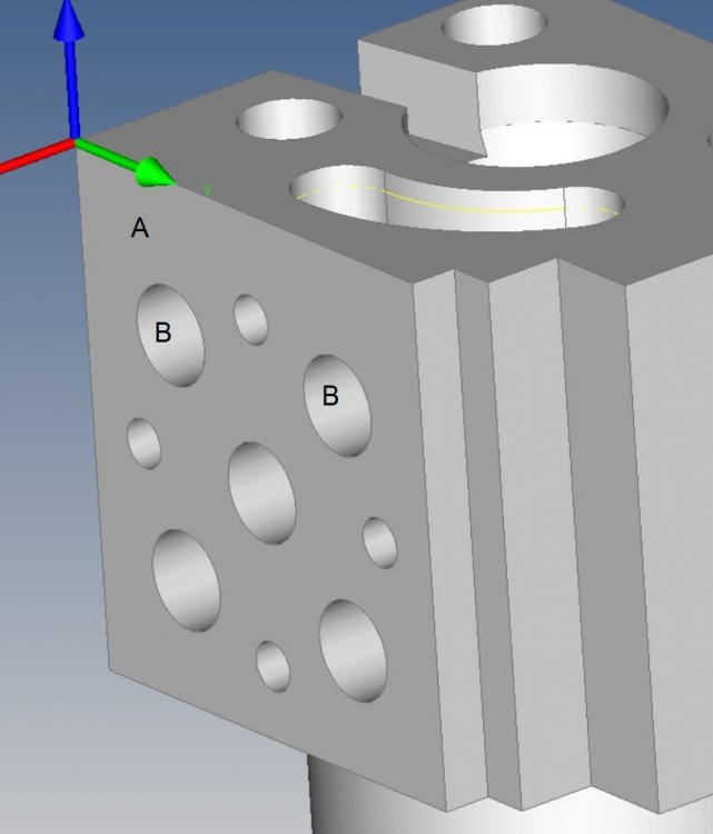

[To...] Posted March 21, 2025 Share Posted March 21, 2025 (edited) Datum A is face and datum B is 2 cylinders. There are several profiles on the top of the part to A and B with MMB. Thought I could create a parallel cylinder but it is not available as secondary datum using Beta GD&T. Any thoughts? Edited March 21, 2025 Link to comment Share on other sites More sharing options...
[Da...] Posted March 21, 2025 Share Posted March 21, 2025 Can you create a symmetry plane between the cylinders and perpendicular to A and use that? Link to comment Share on other sites More sharing options...
[To...] Posted March 21, 2025 Author Share Posted March 21, 2025 Please sign in to view this quote. Unfortunately, this won't help with regards to the MMB. Link to comment Share on other sites More sharing options...

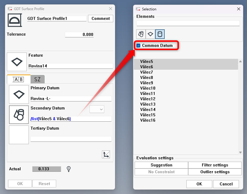

[Pa...] Posted March 21, 2025 Share Posted March 21, 2025 With Beta GD&T you can check the option "Common datum" in element selection and there directly select both individual cylinders. The construction of a parallel cylinder is no longer needed here. Link to comment Share on other sites More sharing options...
[To...] Posted March 21, 2025 Author Share Posted March 21, 2025 Please sign in to view this quote. You are the man... thank yo. Link to comment Share on other sites More sharing options...
[Ju...] Posted March 21, 2025 Share Posted March 21, 2025 Tom was assisting me with this issue, so thanks for the help. I had a follow up question, if you had to do unequal distribution of a profile using the above datums how would you do that? When using the GD&T Beta engine that drop down menu disappears. Link to comment Share on other sites More sharing options...
[Pa...] Posted March 24, 2025 Share Posted March 24, 2025 I think I saw a mention in some intro video from Zeiss about Calypso 2024 that this unequal distribution doesn't exist yet in Beta GD&T Engine. Link to comment Share on other sites More sharing options...
