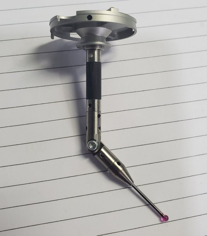

[Ja...] Posted March 24, 2025 Share Posted March 24, 2025 (edited) I don't think you should have much of a problem, as others have said the trick will be setting up a stylus system at that basic angle and approaching it correctly. Since we have a VAST XXT and don't have a fancy RDS head we made a stylus system that has a single probe on an adjustable knuckle for a specific part that has an angled bore inside a tube, so I feel if we can do it without an RDS you shouldn't have much issue. Here's what ours looks like and you can find that knuckle joint on the Zeiss metrology shop as "Rotating knuckle joint, M2 626112-5000-004". Edited March 24, 2025 Link to comment Share on other sites More sharing options...

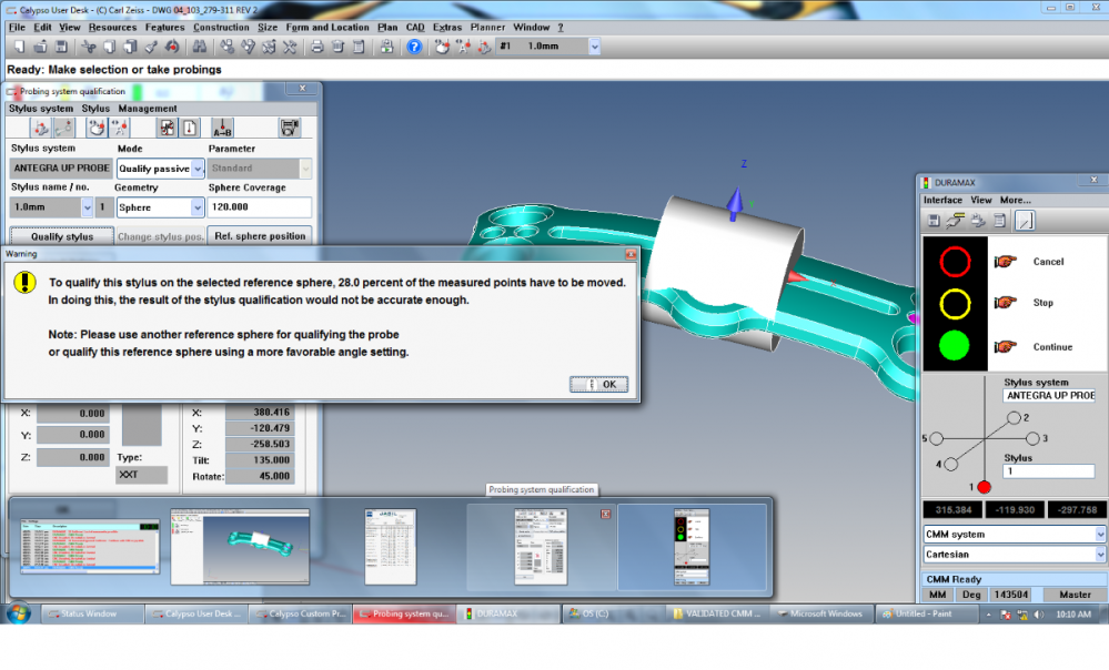

[Ro...] Posted April 10, 2025 Share Posted April 10, 2025 I am trying to create a +Z stylus on a Duramax CMM w/ XXT head. I do this all the time with Contura VAST XT, but the Duramax unit is telling me it needs "28 degrees" and to use a different Ref sphere. The probe extends 65mm and weighs 12.5 grams. Curious if anyone has tried this before? Thanks so much Link to comment Share on other sites More sharing options...
[To...] Posted April 10, 2025 Share Posted April 10, 2025 Please sign in to view this quote. Did you mean to say +Z stylus, i.e. pointing straight up? Link to comment Share on other sites More sharing options...
[Ro...] Posted April 10, 2025 Share Posted April 10, 2025 Yes, The stylus is pointing up. Thank you. Link to comment Share on other sites More sharing options...
