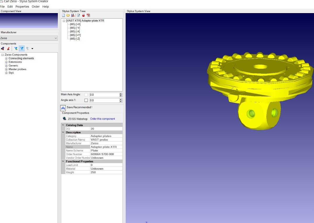

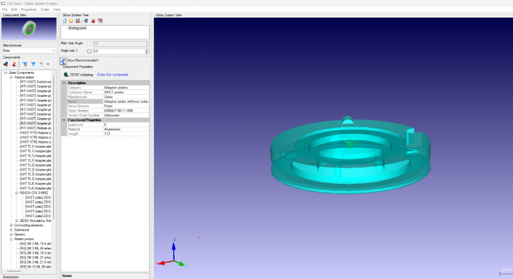

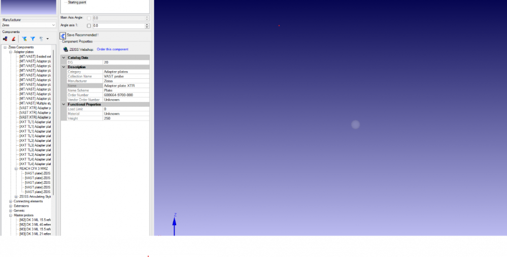

[Ni...] Posted March 21, 2025 Share Posted March 21, 2025 Are VAST XTR and the majority of MT/VAST plates not actually a buildable component in the SSC program? In the Zeiss components directory there are 3 XTR adapter plates. Selecting on any of them will not yieldplate visibility in the stylus system view, and will not export the plate geometry in the SSC file? The first image below is what I am getting when trying to select the XTR plate. The second image is the only TL5 plate that I can find that actually has a buildable component (the MT/VAST adapter plate without cube.) Link to comment Share on other sites More sharing options...
[To...] Posted March 21, 2025 Share Posted March 21, 2025 (edited) Please sign in to view this quote. Like this one? Did you double-click on the selection to add to the tree? Did you start by clicking the New icon and selecting the VAST XTR option? Edited March 21, 2025 Link to comment Share on other sites More sharing options...
[Ni...] Posted March 24, 2025 Author Share Posted March 24, 2025 Hi Tom, Thank you for the reply. I did start using the methods you described above. I tried on my coworker's workstation and the adapter plate generates on his. I am going to try to have IT reinstall the SSC software today on my workstation in the hopes that it corrects the issue. It turns out I am missing a lot of the models; I'm not 100% sure why, but will see about a new software installation. Link to comment Share on other sites More sharing options...
