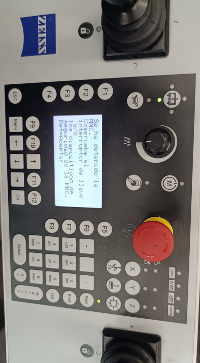

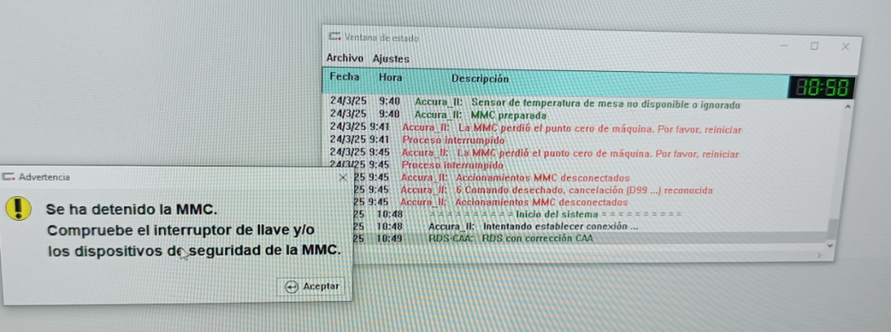

[Da...] Posted March 24, 2025 Share Posted March 24, 2025 Buenas tardes, Al encender la maquina no conseguimos que el accionamiento este activado, y la máquna no hace origenes por lo que no podemos utilizarla. La llave la tenemos en automática, aunque también hemos probado en manual. No conseguimos que el palpador se mueva. Manualmente hemos movido en todos los ejes el vástago pero no conseguimos que conecte. Alguien podría ayudarme o darme ideas que de más podemos hacer? Muchas gracias de antemano. Link to comment Share on other sites More sharing options...
[Ma...] Posted March 24, 2025 Share Posted March 24, 2025 Have you tried restarting ACCURA? Maybe it can be dust or contamination on ruler where it gets it's position. What steps did you perform? Key which you have mentioned has no meaning for this i think - it's only for limiting movement speed. Link to comment Share on other sites More sharing options...
[Da...] Posted March 24, 2025 Share Posted March 24, 2025 Su caja de control no está activada. Primero debe activar el botón con la letra "M" en la parte superior central. Link to comment Share on other sites More sharing options...
[Ma...] Posted March 24, 2025 Share Posted March 24, 2025 Please sign in to view this quote. Or button on control box - but if there is an error, then it may not work. Link to comment Share on other sites More sharing options...
