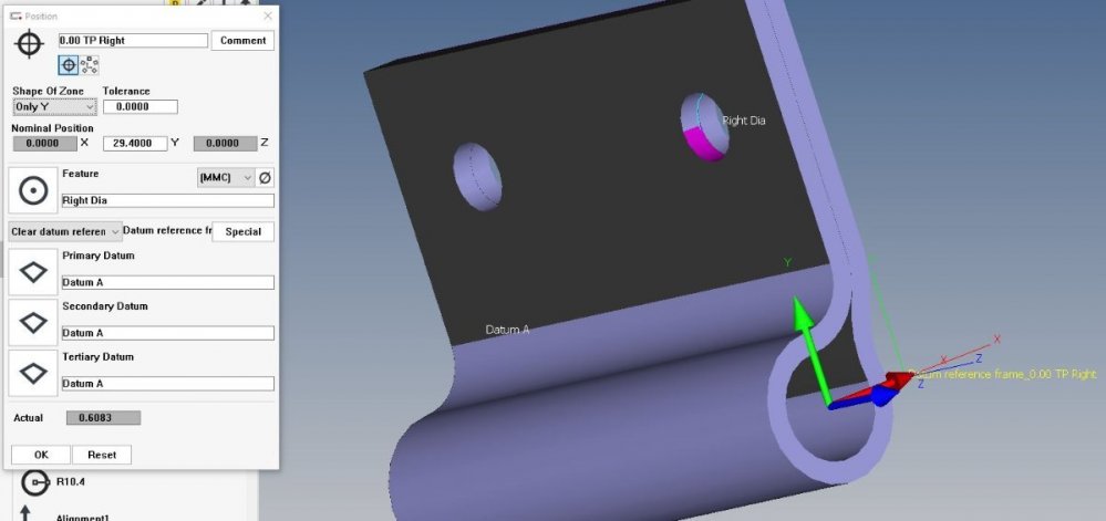

[AG...] Posted March 26, 2025 Share Posted March 26, 2025 Asking for some help with this composite Position? How to set it up? Thank you Link to comment Share on other sites More sharing options...
[AG...] Posted March 26, 2025 Author Share Posted March 26, 2025 Am i setting this up correctly to get this position? Link to comment Share on other sites More sharing options...
[Cl...] Posted March 26, 2025 Share Posted March 26, 2025 (edited) I would use a plane for -A- (Spatial X). A cylinder for -B- (Planar Z/XY origin) and a line plane for -C- (origin Z). Edited March 26, 2025 Link to comment Share on other sites More sharing options...
[To...] Posted March 26, 2025 Share Posted March 26, 2025 (edited) You need to create a true position, change it to a best fit bore pattern (the icon next to the true position icon near the top under the label). Enter the tolerance Set Datum A as the Primary and leave the secondary and tertiary blank. Click the feature button (above "Clear datum reference"), add both cylinders, then set the best fit to allow rotation and translation. Click OK Click the MMC button. Click Calculate to refresh all the settings. Click the green Plot icon, then click plot button. Edited March 26, 2025 Link to comment Share on other sites More sharing options...
[AG...] Posted March 26, 2025 Author Share Posted March 26, 2025 I followed what you both had said, thank you, much appreciated. The MMC is showing at 0.00 still? I must be having a really, really long day because something doesnt look right to me? Link to comment Share on other sites More sharing options...
[Ri...] Posted March 26, 2025 Share Posted March 26, 2025 The (.M) does not work if the base tolerance is 0. I've requested this be addressed and fixed. The (.M) is just a statistical calculation either way, it means nothing to manufacturing. Link to comment Share on other sites More sharing options...
[Ri...] Posted March 26, 2025 Share Posted March 26, 2025 Please sign in to view this quote. Please see Tom's instructions. They have to be evaluated together for the lower portion. Link to comment Share on other sites More sharing options...
[AG...] Posted March 26, 2025 Author Share Posted March 26, 2025 Thank you, much appreciated. I will remember this for the future. Link to comment Share on other sites More sharing options...
