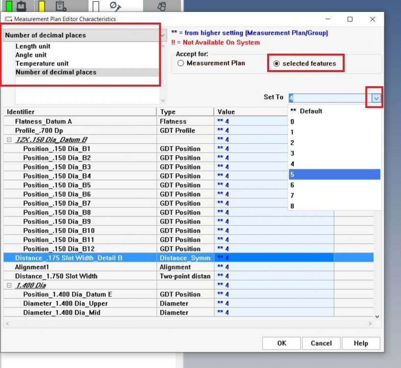

[Br...] Posted March 30, 2025 Share Posted March 30, 2025 Have a rather simple question. I have a single characteristic that I would like to report to 5 decimal places while keeping the rest of the report at 4 decimal places. Change the decimal place to 5 on a single characteristic...does anyone know if this can be done? ~ Thanks in advance Link to comment Share on other sites More sharing options...
[To...] Posted March 30, 2025 Share Posted March 30, 2025 (edited) Please sign in to view this quote. Go to Resources > Characteristics Settings Editor At top, select dropdown menu and select Units > Number of Decimal Places At top right, tick Selected features, then select the desired characteristic Select Set To dropdown menu and set to 5. Click OK Edited March 30, 2025 Link to comment Share on other sites More sharing options...
[Br...] Posted March 31, 2025 Author Share Posted March 31, 2025 Oh, my word Tom that was too easy, I should have known. Next time I'll make it worth your while and give you a real doozy. Thanks much! Link to comment Share on other sites More sharing options...
