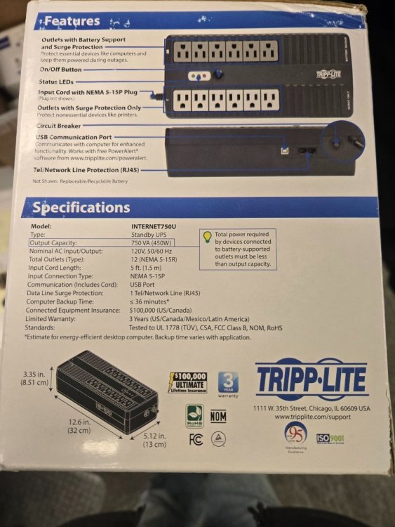

[Ri...] Posted April 2 Share Posted April 2 Looking for information on batter backups for a Micura CMM. Please see the attached image, this unit is 750VA (450W). Would this unit be suitable to give an operator time to shut down a CMM during loss of power? (Assuming the CMM is running a program). Link to comment Share on other sites More sharing options...
[Cl...] Posted April 2 Share Posted April 2 We don't have a Micura, but on our O-inspects we use a battery back-up made by N1 Critical Technologies. Its specs are AC output is AC110/120V.50/60Hz, 15.0A Max. Based on this I think the answer to your question is yes. Link to comment Share on other sites More sharing options...
[Ji...] Posted August 27 Share Posted August 27 We use ACP UPS 2000 for the Prismo and Contura. They will stay up for over an hour when the power goes out. I would say the one you are looking at should give them plenty of time to save if they are programming or to stop the run. Link to comment Share on other sites More sharing options...
