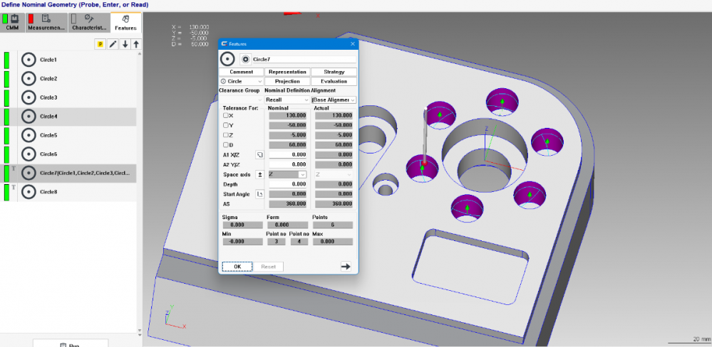

[Ad...] Posted April 4, 2025 Share Posted April 4, 2025 currently using a pattern to measure 4 circles creating a theoretical circle from these 4 circles the diameter of the theoretical circle is smaller diameter than when i use the R value in a caliper distance. what am i doing wrong? Link to comment Share on other sites More sharing options...

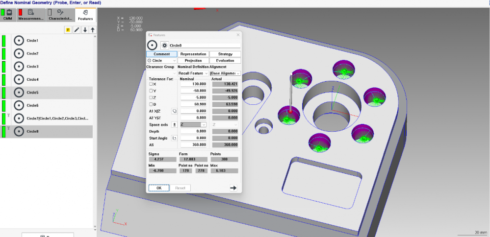

[Ma...] Posted April 4, 2025 Share Posted April 4, 2025 Recall - it will recall origin point of selected feature/s Recall feature - it will recall measured actuals into features nominals - that's why you cal recall only one feature Recall Feature Points - it will recall all measured points into feature - used when measuring 4 single planes but need to have one from all data Link to comment Share on other sites More sharing options...
[Ky...] Posted April 4, 2025 Share Posted April 4, 2025 Just as a graphical description of what Martin is saying, this is what you get when you use recall: This is what you get when you do recall feature points: Since you are taking every individual point measured in the circles describing the bore pattern, you get odd results. This document on the knowledge base describes how to set up bore patterns properly: https://portal.zeiss.com/knowledge-base?id=1769725 Hope that helps. Link to comment Share on other sites More sharing options...
