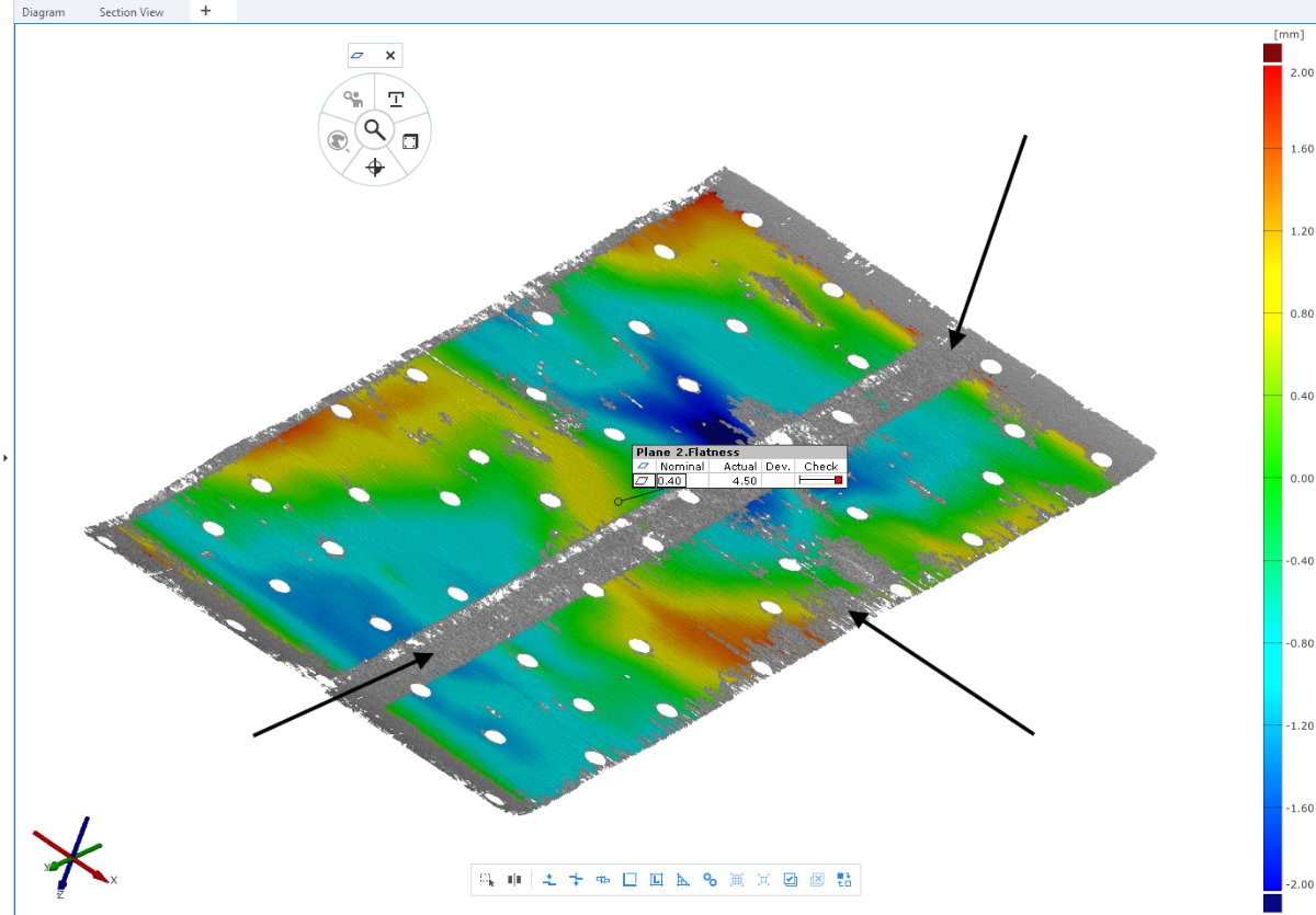

[Su...] Posted April 7, 2025 Share Posted April 7, 2025 Hi everyone, I'm working with ZEISS INSPECT and currently only have scan data (STL mesh) — no CAD model is available. I would like to measure the flatness deviation of a planar surface, and ideally obtain the maximum and minimum deviation values from a defined reference plane. Is there a way to: 1. Create a reference plane directly from the mesh? 2. Compare a selected surface region to that reference plane? 3. Generate deviation values (min/max/avg) or a color map without needing a CAD? Any help, screenshots, or workflow steps would be greatly appreciated! Thanks in advance. Link to comment Share on other sites More sharing options...

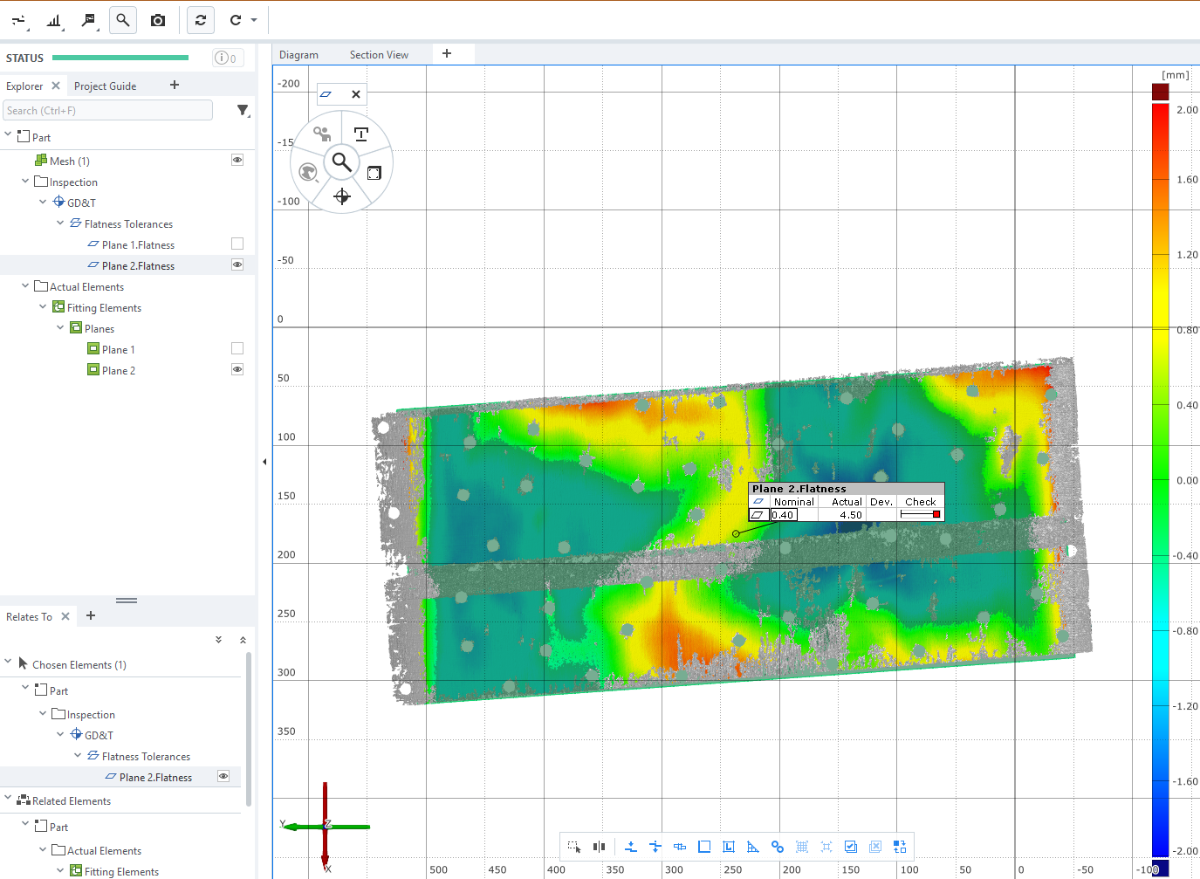

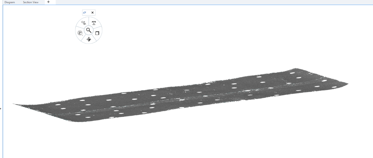

[Sw...] Posted April 24, 2025 Share Posted April 24, 2025 Hi Please sign in to view this username. Thanks for the guidance. I have attached some images where I am unable to view the flatness deviation in some of the regions especially the curved regions of the mesh. How can I view the deviation on those grey regions marked with black arrows(as represented in the image_1b)? Also, 0.4 was the tolerance that I had set. What does 4.5(actual) in indicate(as seen in the image)? ________________________ For Reference Image_1a = 2D orthographic view Image_1b = Isometric view Image_1c = Isometric view of scanned mesh .stl (curved at the end) Link to comment Share on other sites More sharing options...
[Na...] Posted April 24, 2025 Share Posted April 24, 2025 Hi, please click on Plane 2 in the explorer -> RMB -> Edit creation parameters and use the selection tools on the bottom of the 3D view to select the missing areas. Then press OK and the flatness will be calculated with the new selection. Please see the techguide for a detailed explanation: https://techguide.zeiss.com/en/zeiss-inspect-2025/article/cmd_inspection_check_flatness.html Please sign in to view this quote. Nanno Link to comment Share on other sites More sharing options...

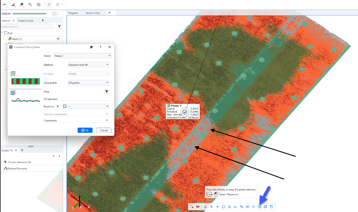

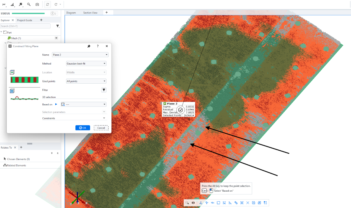

[Sw...] Posted April 24, 2025 Share Posted April 24, 2025 Hi Please sign in to view this username. I did implement the way you instructued. It definitely works but the catch with my scanned .stl file is, I have to click multiple time at different regions as is shown in the image in the arrow which points to the multiple clicks that I did on to the mesh file. Is there any way to select the entire region easily(as you can see there are still so many regions left)? Link to comment Share on other sites More sharing options...
[Na...] Posted April 24, 2025 Share Posted April 24, 2025 Hi, you can "select all" with this button in the state of the screenshot: Link to comment Share on other sites More sharing options...
