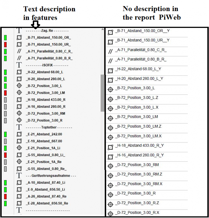

[Ma...] Posted April 10, 2025 Share Posted April 10, 2025 (edited) Hello. I have a question. In the previous version of Calypso, when I added a text element in the features, this text was also displayed in the report. Now that we have PiWeb reporting, there is no such description in the report. Is there a way to restore it? Calypso version 7.8. Edited April 10, 2025 Link to comment Share on other sites More sharing options...
[Mi...] Posted April 10, 2025 Share Posted April 10, 2025 (edited) See here: https://qualityforum.zeiss.com/topic/6630-„textelement“-wird-nicht-angezeigt/#comment-26522 https://qualityforum.zeiss.com/topic/4526-manual-notes/#comment-13690 Edited April 10, 2025 Link to comment Share on other sites More sharing options...
