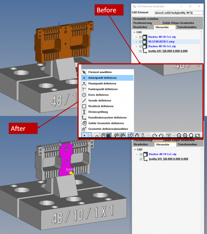

[Mi...] Posted April 10, 2025 Share Posted April 10, 2025 Hello Community, i have the currios Proplem/Bug that my CAD Files (Part and clampingdevices) get merged into each other when i create a symmetry point or normal Point.. Right now i dont know if other elements also merge the CAD Files.. Do you also experience strange behavior or is it just me? Can someone test and verivy for me? Is it preventable somehow? Thanks for your Contribution! Link to comment Share on other sites More sharing options...

[Ri...] Posted April 10, 2025 Share Posted April 10, 2025 I've had this same issue if I hid CAD bodies, and then told Calypso to show all CAD bodies again. Other than that specific issue, I haven't had this issue. Link to comment Share on other sites More sharing options...
[Th...] Posted April 11, 2025 Share Posted April 11, 2025 Just tested and verified this happens to me too. For the symmetry point, it happens the moment you define the first point within the feature. For defining individual points, it should be simple enough to use the space point tool instead and change the point evaluation mode if you need something else. For symmetry point, I think you would have to create the points as their own features and then recall them for the symmetry point. That doesn't affect the CAD, but I can't think of a way to define the points from within the sym point strategy without that happening. Link to comment Share on other sites More sharing options...
