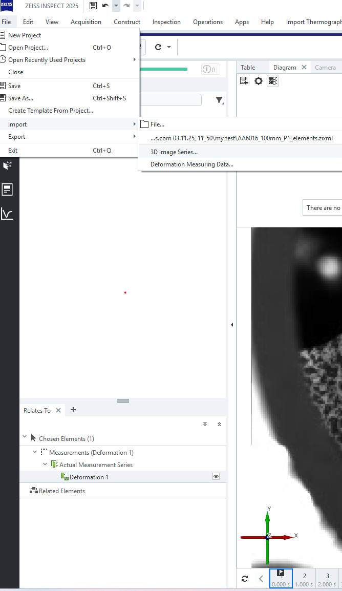

[Er...] Posted April 15, 2025 Share Posted April 15, 2025 Hello, I am new to Zeiss Correlate and I want to understand how can I import multiple images in single import? I have deformation images but whenever I select multiple images, it just imports the first one. For importing each of them, I can only do it one-by-one. How can I solve this? Thanks in advance. Erencan Link to comment Share on other sites More sharing options...
[Mo...] Posted November 12, 2025 Share Posted November 12, 2025 Hello Oranli, You can import the multiple image series via “File->Import->3D Image Series. you need the calibration file and also the left and right kamera images. or you select all the images at once the per drag and drop import them (for 2D) Regards Mohamed Link to comment Share on other sites More sharing options...
