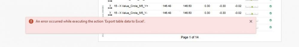

[An...] Posted April 15, 2025 Share Posted April 15, 2025 I am trying to export PiWeb data into excel with mixed results. I got a template from this forum with an excel button built in and it works great. I tried to replicate that button in an existing template we have and it does not work, I get an error message(attached). I even tried copying the button directly and no such luck. Any ideas? ForumStandardProtocol_Excel Export.ptx A StandardProtocol_EXCELTEST - Copy.ptx Link to comment Share on other sites More sharing options...

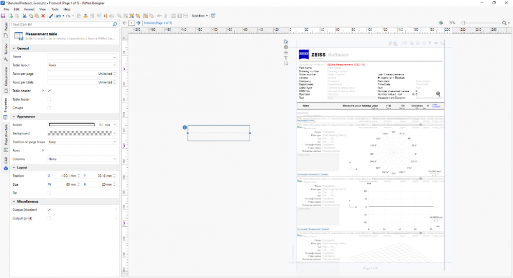

[Ri...] Posted April 15, 2025 Share Posted April 15, 2025 (edited) You need a button as well as a Measurement Table that is hidden off the page. Make sure the Measurement Table is data bound to your part as well. 🙂 Edited April 15, 2025 1 Link to comment Share on other sites More sharing options...
[An...] Posted April 15, 2025 Author Share Posted April 15, 2025 YES! Thank you, I was missing the hidden measurement table. Now it works great Link to comment Share on other sites More sharing options...
