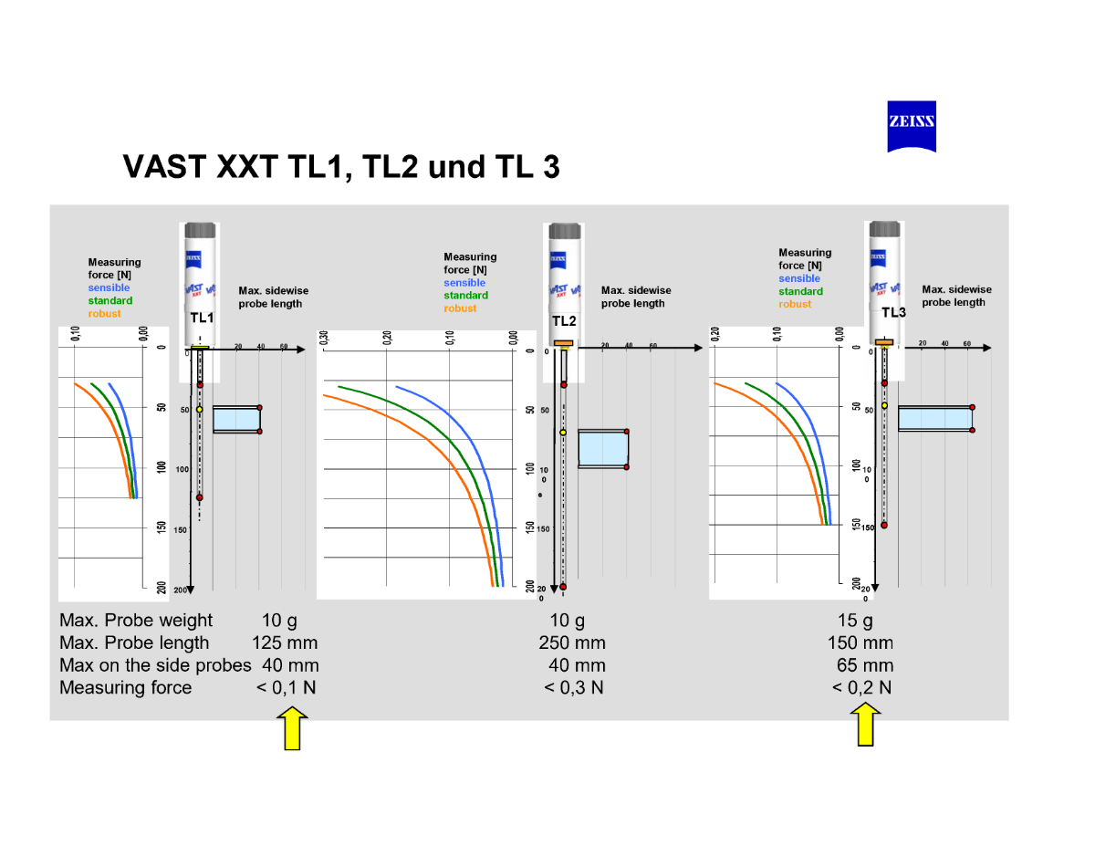

[FL...] Posted April 16, 2025 Share Posted April 16, 2025 What does changing these settings do? Also, what does changing the force and dynamic do? Probing Behavior Deflection Values: Sensitive: 100 μm Standard: 150μm Robust: 200μm I seem to get this error often "The sensor did not carry out the measurement with the expected measuring force", what does it mean? Link to comment Share on other sites More sharing options...
[Ow...] Posted April 16, 2025 Share Posted April 16, 2025 Please sign in to view this quote. Standard presetting: The recommended presetting for the deflection is »Standard«, selectable in the CALYPSO measuring software. With this setting, the probe deflection during measurement value recording is 0.15 mm, this value is independent of the stylus length. Modes for critical application cases: Sensitive: Small deflection, for example for soft workpieces or low scanning speed. Robust: High deflection, for example for rough workpieces. The XXT is a passive sensor and relies on a certain amount of deflection. Standard is 150um, Sensitive is 100um and Robust is 200um. If the feature you are scanning has high form or location error, the sensor is not able to maintain its given deflection amount which causes the sensor to report the "air scanning" message. Scanning Optimization will re-measure the feature based on the data it was able to collect but at a slower speed. Doesn't apply to lines or planes. You can turn the Scanning Optimization off in the resources, compatibility settings but there is an increased risk of incorrect results and repeatability is most likely compromised. Link to comment Share on other sites More sharing options...

[Ri...] Posted April 16, 2025 Share Posted April 16, 2025 Link to comment Share on other sites More sharing options...
[FL...] Posted April 16, 2025 Author Share Posted April 16, 2025 If you use sensitive or robust will it change measurement results? Does the probe need to be calibrated with these setting? Or is it ok if it’s calibrated using standard Link to comment Share on other sites More sharing options...
[Ri...] Posted April 16, 2025 Share Posted April 16, 2025 It qualifies with all three settings during the Passive Qualification. Changing the setting during qualification just changes the default behaviour. Link to comment Share on other sites More sharing options...
