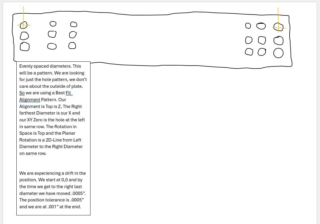

[AG...] Posted April 17, 2025 Share Posted April 17, 2025 I am was wondering for any direction with this? I have many hole patterns that i have checked and they range between .0005"-.001" on position. The only thing that matters is the pattern not the outside of the plate. I am getting a drift from 0,0 to the end of plate on the last diameter taken. It starts out at nominal but is out of position .001" at the end? Thank you for any help with this, much appreciated. Link to comment Share on other sites More sharing options...

[AG...] Posted April 29, 2025 Author Share Posted April 29, 2025 Please sign in to view this quote. I know that the CMM can hold .0005" hole position on a 36" flat plate from beginning to end. I have ran the same plate on the other CMM and it repeats measurements. I don't usually compare one to the other. When the operator uses the probe in the machine they get within .0002" at the end of pattern. This has been ongoing with bosses and why the CMM uses up all the tolerance end to end. I just feel that there is something i can do differently and i cant pinpoint it. Link to comment Share on other sites More sharing options...
[DW...] Posted April 29, 2025 Share Posted April 29, 2025 Please sign in to view this quote. Please sign in to view this username. Make your rotation a 3d line recalled from hole1 and hole2 and project that line to the top face and make sure the direction for rotation is correct (I am assuming +X). Last time you qualified the probe? Sigma values? Link to comment Share on other sites More sharing options...
[AG...] Posted April 29, 2025 Author Share Posted April 29, 2025 Please sign in to view this quote. That is how i have my Rotation set up. Thats another reason why im not getting that it is moving that much. I qualify 3 times a week, sigma value .00001" Link to comment Share on other sites More sharing options...
[DW...] Posted April 29, 2025 Share Posted April 29, 2025 Please sign in to view this quote. Please sign in to view this username. I thought you were using a non projected 2d line? Any possibility of shanking? Single points vs scanning? Link to comment Share on other sites More sharing options...
