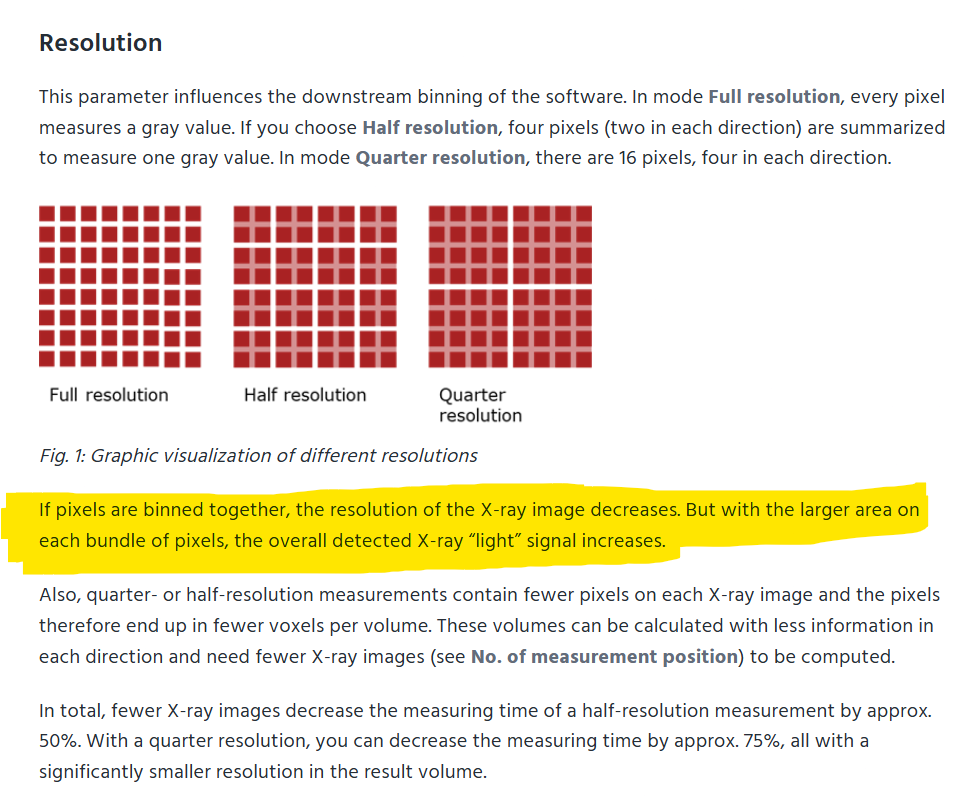

[Ti...] Posted April 19, 2025 Share Posted April 19, 2025 (edited) Once we set our scan at 120mm or less zoom, we get very poor surface quality on the volume and polygonized mesh if we use full resolution. If we use half resolution the volume and scan looks absolutley amazing!!! We are better off scanning 2 parts at 60 zoom at half resolution than 4 parts full resolution at 120 zoom. That works for small parts, but for larger parts that need to be moved out to 120mm zoom we get poor surfaces. The same part pushed back to 300mm zoom will look amazing, but we lose resolution at 300mm obviously. We have many .05mm tolerance surface profiles and scan quality is critical for us. Once we go to 60mm zoom we cannot consider using full resolution if our part has surface profile tolerances, we must use half resolution...Could someone that works in the xray department comment on this issue? We've been using the Metrotom for 4 years and tried everything you can imagine...we've tried no filter, .5Cu, 1mm Cu, 1000-3000 images, 200-1200ms, hardening on/off, etc, volume filtering off/on, etc. This has to be a known issue. Thanks Edited April 19, 2025 Link to comment Share on other sites More sharing options...

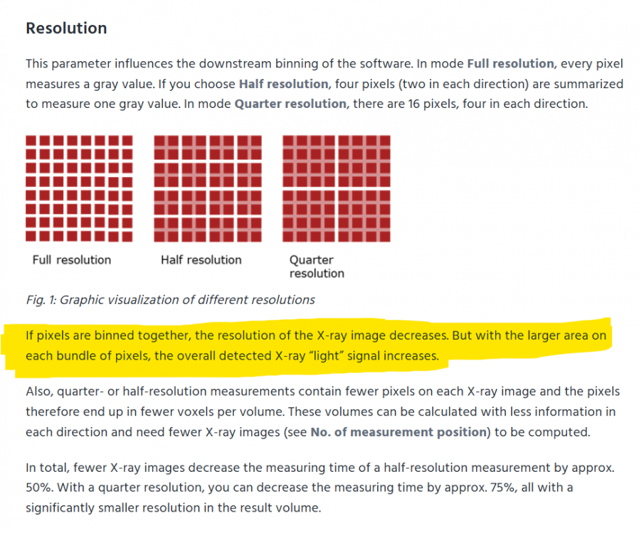

[DW...] Posted April 21, 2025 Share Posted April 21, 2025 Please sign in to view this username. The attachment is from the Tech Guide in the Zeiss Quality Suite. I never use full resolution, because the software is assigning a grey value to every single pixel. As I understand it, this is why you get the rippled surface effect. My go to for acqusition is to use the suggested full resolution images (for example 3000) and then change the quality to half resolution. This way I have plenty of images available for a high quality volume reconstruction, but it then uses 4 pixels (2 in each direction) for that same gray value as it does in high resolution. This strategy has been much more representative of the actual surface. By taking double the amount of recommended images for half resolution, I also find I don't lose some of my smallest features. Play around with it and see if you can get similar results. Link to comment Share on other sites More sharing options...
