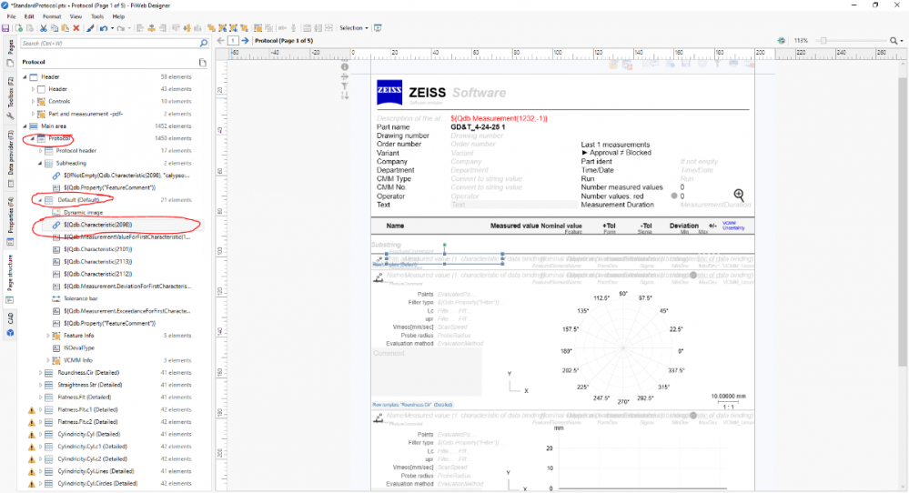

[Ca...] Posted April 24, 2025 Share Posted April 24, 2025 Is there a way to not show _x, _y or _z when using caliper distance in Piweb reporting ? Link to comment Share on other sites More sharing options...

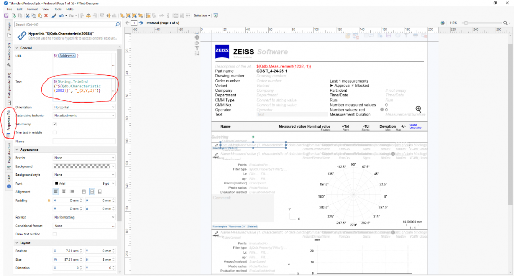

[Ri...] Posted April 24, 2025 Share Posted April 24, 2025 (edited) You will need to modify the report to remove specific characters. ${String.TrimEnd("${Qdb.Characteristic(2002)}", "_(X,Y,Z)")} Edited April 24, 2025 1 Link to comment Share on other sites More sharing options...
[Ca...] Posted April 29, 2025 Author Share Posted April 29, 2025 Thank you very much, this work perfectly. Link to comment Share on other sites More sharing options...
