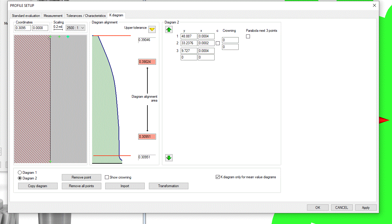

[Lo...] Posted April 25, 2025 Share Posted April 25, 2025 Hello Everyone, I was wondering if someone could shed some light on this issue. I am inspecting a gear and creating a K Chart. When I input the data for Y&Z the diagram disappears. At first both of diagram 1 & 2 disappeared. Not sure what I pushed diagram 1 came back. Not sure how to get diagram 2 back though. Can someone explain to me what I did wrong? Thank you! Link to comment Share on other sites More sharing options...
[Ro...] Posted April 28, 2025 Share Posted April 28, 2025 Check the scaling, maybe you just zoomed-in? On the lower left side you can change between the input for "Diagram 1" and "Diagram 2". At the moment no. 2 is activated. Otherwise provide the .gear or .act to me or my colleagues from support´s team. Link to comment Share on other sites More sharing options...
