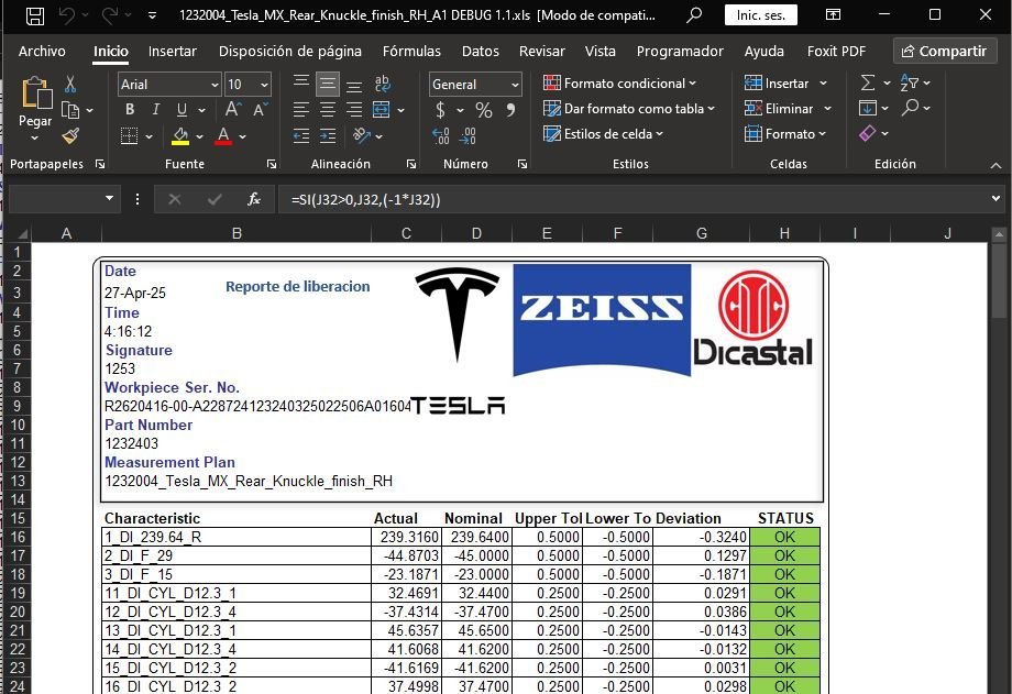

[Ch...] Posted April 27, 2025 Share Posted April 27, 2025 MY PROBLEM IS THAT I WANT TO ADD THE MACHINE AND SEVERAL THINGS BUT IN THE LIST ReporteINI.xls I don't have that option and I don't know how I can recall the data someone could guide me or some available manual that they handle (annex evidence) Gracias Tec. CMM Chris Anthony Link to comment Share on other sites More sharing options...

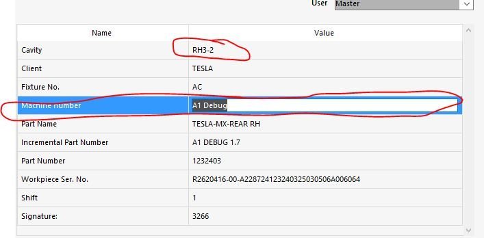

[A...] Posted May 5, 2025 Share Posted May 5, 2025 Calypso finds Report Headers in 2 INI files. The first is userfields.ini ( Located "C:\Users\Public\Documents\Zeiss\CALYPSO\protocol\protform" ). In here you should note 2 things, the id in [*]'s and exactly what it says in name=*. In the ReportINI.xlt you have to find/replace headers you need/don't need. For example, in Row 10 it has "| filename | File Name |" You can replace it with "| u_example | Example |" The important thing is it has to match what the userfields.ini. In characteristics.xlt, anywhere from A1:H12 is your Header Field that Calypso will recognize. In this area, you put "Example" and a blank space below it. Calypso will put the value from your header here. This is kind of a light explanation but hopefully it helps. 1 Link to comment Share on other sites More sharing options...
[Ch...] Posted May 15, 2025 Author Share Posted May 15, 2025 thank you, it really worked for me Link to comment Share on other sites More sharing options...

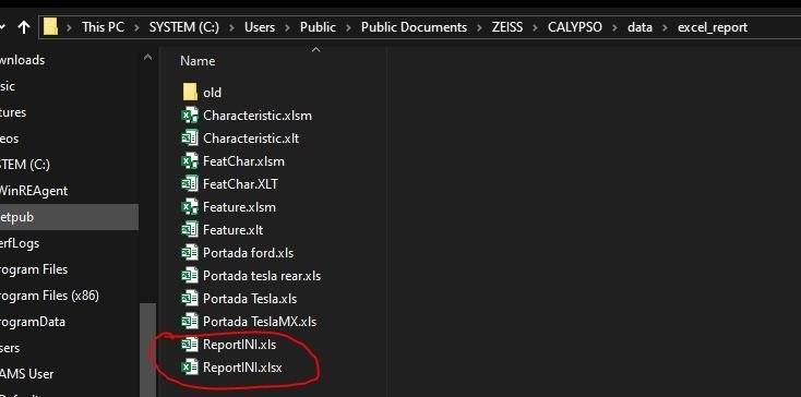

[Ch...] Posted July 24, 2025 Share Posted July 24, 2025 A Szagesh, I tried your suggestions and I can't get the Excel sheet to populate with any data. Steps I took: 1. Made copies of Characteristic .xlt and .xls files and Report .xls 2. Added correct username fields to all 3 files to get additional header info 3.Moved old files to temporary folder 4. Placed new modified files in excel_report folder 5. Selected the new template in the Define Report and ran the program. The new template shows up but is empty of all data, including fields I didn't touch. Any thoughts? Link to comment Share on other sites More sharing options...

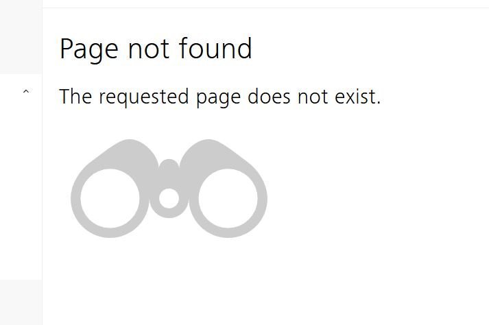

[An...] Posted August 6, 2025 Share Posted August 6, 2025 Here is a knowledge base article that goes into further details on adding custom headers for Excel in CALYPSO. I hope this helps. https://portal.zeiss.com/knowledge-base?id=1664567 Link to comment Share on other sites More sharing options...
[Ch...] Posted August 14, 2025 Author Share Posted August 14, 2025 ¿QUÉ HAGO? Link to comment Share on other sites More sharing options...
[Ma...] Posted August 14, 2025 Share Posted August 14, 2025 Still the same - no one tries to find why is knowledge base not accessible 1 Link to comment Share on other sites More sharing options...
