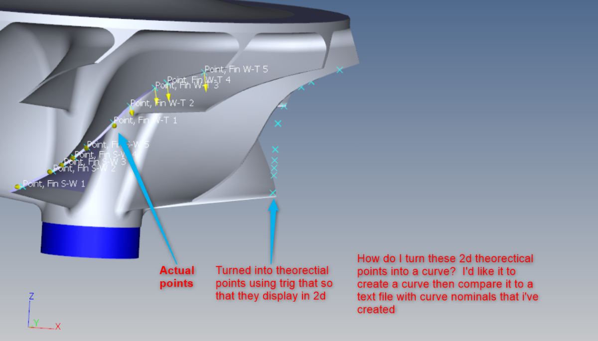

[Ch...] Posted April 30 Share Posted April 30 How do I create a curve from theoretical points? I feel like this should be possible, but I can't figure out how. I have been doing too much management stuff and even have my own cmm programmer now; please tell me that I'm not losing my touch. 1 Link to comment Share on other sites More sharing options...

[Ch...] Posted April 30 Author Share Posted April 30 I don't think I'm being clear about the goal. There is no existing curve. The points are not in a straight line and can't be created with curve. It's hard to tell in the picture, but the theoretical points are all in the same plane, while the original points are not. I could make it using FreeForm, but I can't report radius's as they change along the compressor wheel profile. They are individual points taken along the edge of a compressor wheel. Then I create theoretical points and use formulas to put all the points in the same plane. In a perfect world I could recall those theoretical points into a curve. But it won't let me. Link to comment Share on other sites More sharing options...

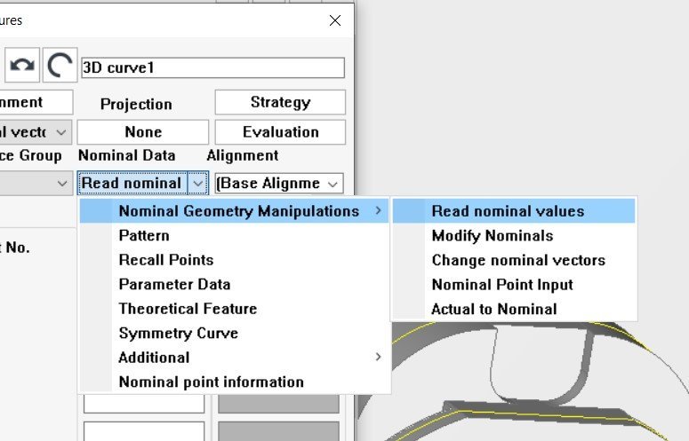

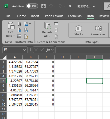

[Ow...] Posted April 30 Share Posted April 30 (edited) It's been awhile since I've done it but, basically type your nominals into different columns of an excel document and then save the document as a (Tab Deliminated).txt file and then read that file into curve like Tom defined above. In the 2D curve example illustration I've attached, first row is X, 2nd Y, 3rd row Z. If it is a 3D curve, you'll need the Unom, Vnom,wnom's vectors as well.(I,J,K). Edited April 30 Link to comment Share on other sites More sharing options...

[Iv...] Posted December 17 Share Posted December 17 Please sign in to view this username. Yes, but that would only create the nominal curve, correct? In this case, I already have the nominal curve, but I'm unable to get the actuals into the curve since they are theoretical, and CALYPSO will not allow it. Below is the concept that I'm producing. Creating the theoretical symmetry points based on the max/min coordinate points of multiple opposing curves. I'm then able to bring these into a curve feature using the delte method that I mentioned above (somewhat). Because I already have the nominal points from the symmetry points, and there are only 14 points, I created it by hand. If there were more points, I would've used the method you mentioned to create the nominal path. Link to comment Share on other sites More sharing options...
