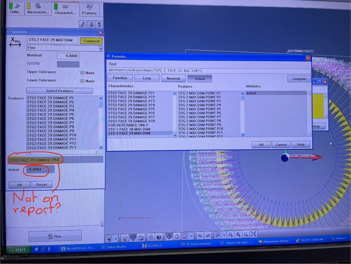

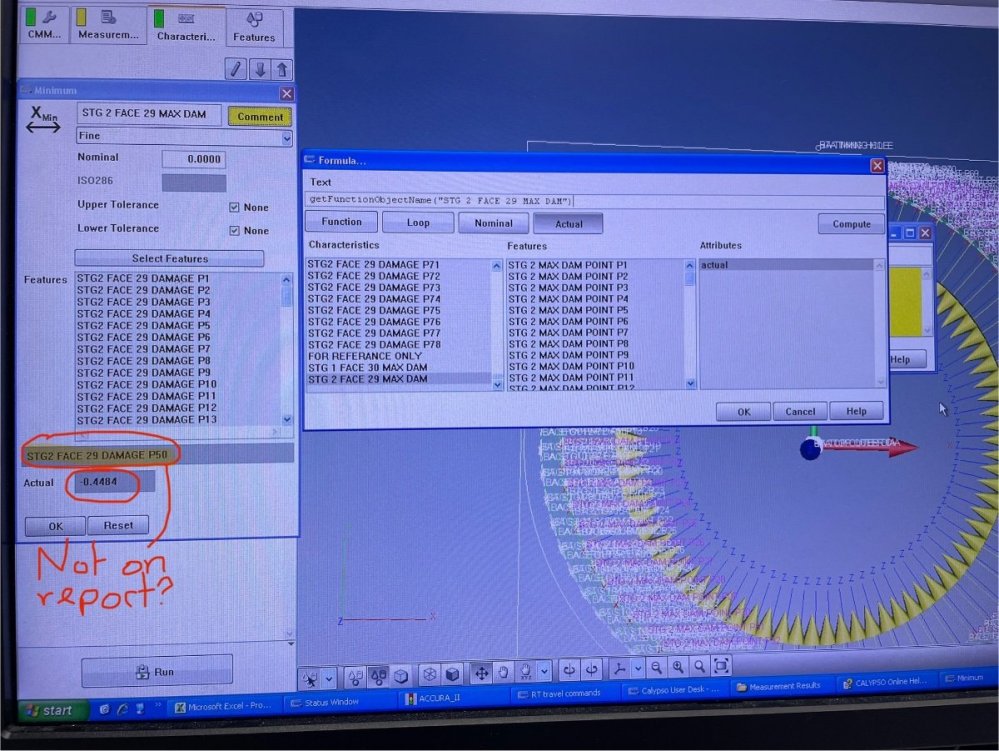

[Se...] Posted May 3, 2025 Share Posted May 3, 2025 Hello there, We are measuring a series of stepped faces, 44 pairs in total, and we would like to know which ones are the max and min, we can get the figures and offending feature name using Minimum X etc, but it doesn’t tell us in the report which of the offending 44 it relates to, just the value? We have tried using a formula but no joy, we don’t have PCM but feel we shouldn’t need it for this. Link to comment Share on other sites More sharing options...
[Ch...] Posted June 3, 2025 Share Posted June 3, 2025 getActual("STG 2 FACE 29 MAX DAM").result.whichIsMinMax requires PCM I agree this should be an option to output by default without PCM. 1 Link to comment Share on other sites More sharing options...
[Cl...] Posted June 3, 2025 Share Posted June 3, 2025 (edited) I don't have access to Calypso today, but wouldn't a Result Element work for this? Edited June 3, 2025 Link to comment Share on other sites More sharing options...
