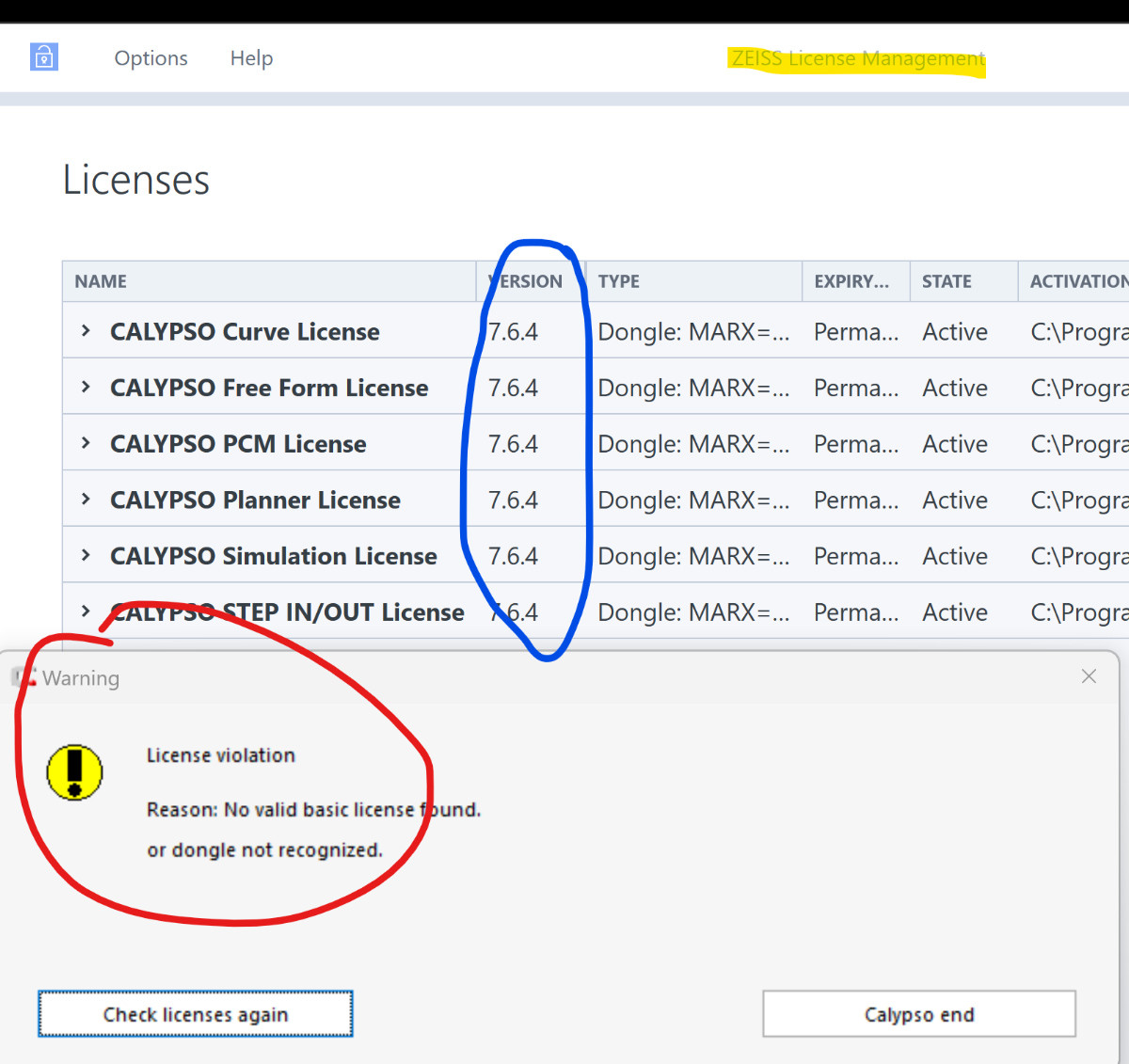

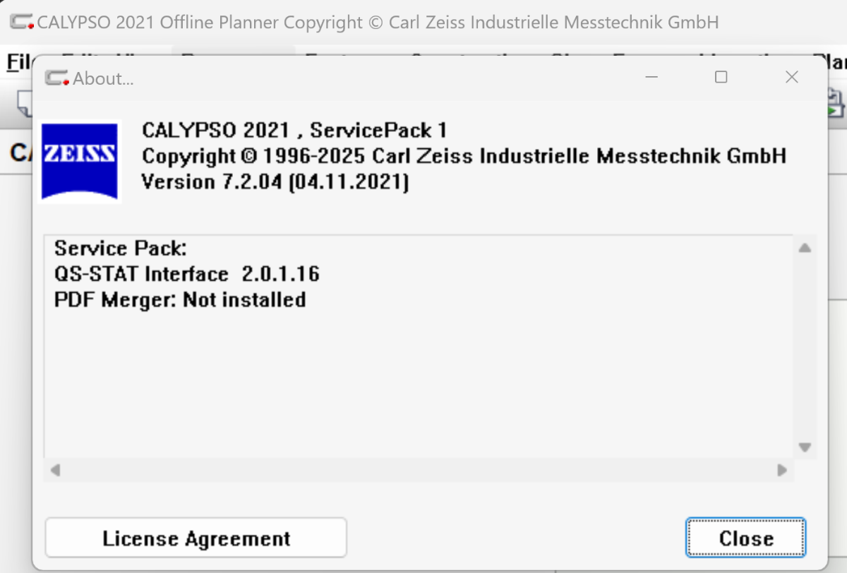

[Jo...] Posted May 5, 2025 Share Posted May 5, 2025 Hey guys, I have a new offline PC and a Dongle. I am encountering an issue with the license while opening Calypso 2024. Calypso 2021 works fine and opens normally. Opening my license utility, it shows that my license is valid to 7.6.4 all shows active. I have no other inactive licenses shown within my license manager. Any thoughts on the issue? Thanks in advance! Link to comment Share on other sites More sharing options...
[Ow...] Posted May 5, 2025 Share Posted May 5, 2025 Please sign in to view this quote. When I went to 2024 back in December of last year, I had a lot of trouble with licensing and it took them 3 days to figure it out. However, 2024 is Calypso version 7.8, so, 7.6 licenses won't work, right? 1 Link to comment Share on other sites More sharing options...
[Jo...] Posted May 5, 2025 Author Share Posted May 5, 2025 Ahh that's a good point Please sign in to view this username. ! For some reason, I forgot that the Calypso version goes up 0.2 every year. Problem solved haha 1 Link to comment Share on other sites More sharing options...
[Ab...] Posted May 6, 2025 Share Posted May 6, 2025 Hello you will need to update license to 7.8 version here are instructions https://portal.zeiss.com/knowledge-base?id=444908 Link to comment Share on other sites More sharing options...
