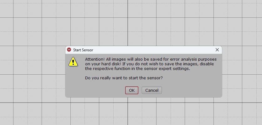

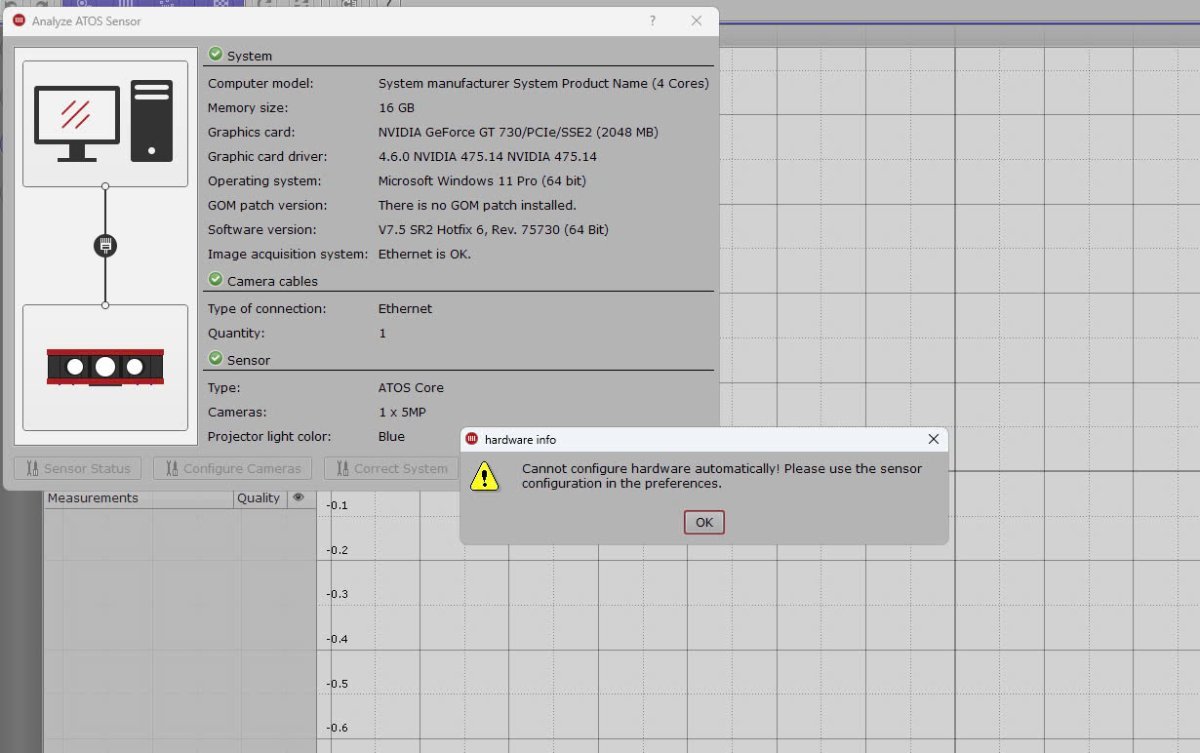

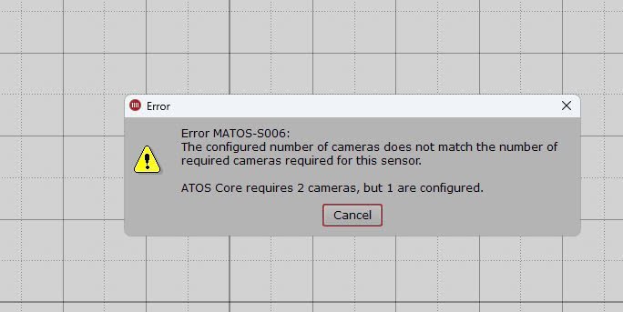

[Ba...] Posted May 6, 2025 Share Posted May 6, 2025 Hello everyone. I can't connect my new computer to the Sensor. The software shows a message about not being able to auto connect and some errors when I try to start the camera. Link to comment Share on other sites More sharing options...
[St...] Posted May 6, 2025 Share Posted May 6, 2025 Hello V7.5 is not supported under Windows 11. To be able to work with Windows 11 please use the software versions 2022 or later. You will find more details to this issue in our Techguide ZEISS Quality Tech Guide Link to comment Share on other sites More sharing options...
