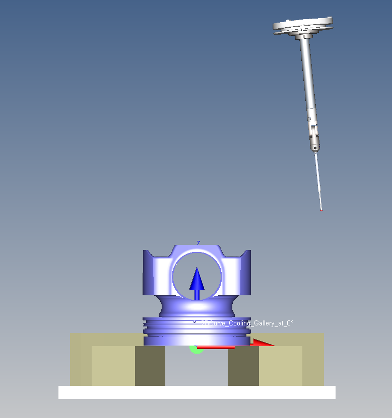

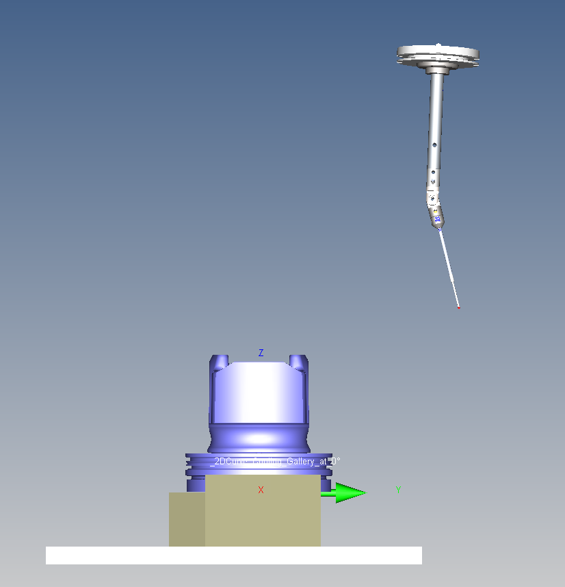

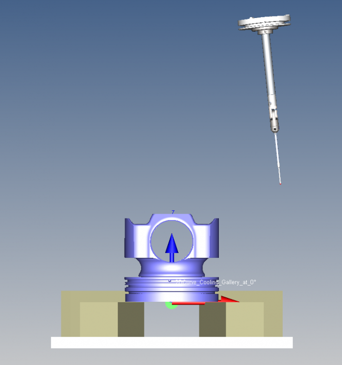

[Ja...] Posted May 6, 2025 Share Posted May 6, 2025 Good morning. While running one of my programs through simulation, I noticed that the probes were crooked. For obvious reasons, this is causing collisions while inspecting the part. I opened other programs, and while this is not happening on all programs, it is significant amount. Please let me know if anyone else has encountred this issue and how it got resolved. Link to comment Share on other sites More sharing options...
[To...] Posted May 6, 2025 Share Posted May 6, 2025 Close Simulation. Resources > Utilities > Set Base Alignment to Zero 1 Link to comment Share on other sites More sharing options...
[Ja...] Posted May 6, 2025 Author Share Posted May 6, 2025 Tom. Thank you. That seemed to have done it. Link to comment Share on other sites More sharing options...
