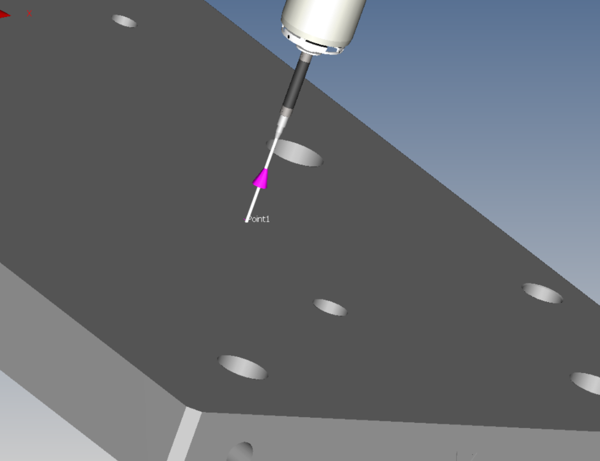

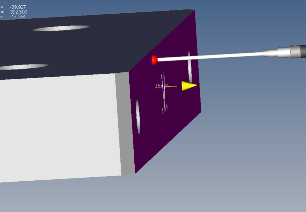

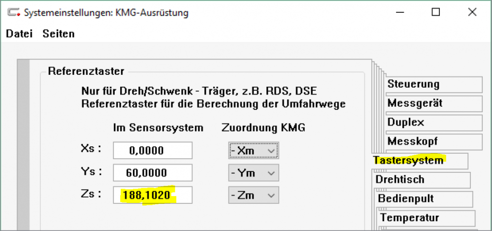

[Ji...] Posted May 7, 2025 Share Posted May 7, 2025 (edited) Hello all, After i imported SSC file, 1# styli is corrected. But when i created 2# or 3#..., it's always not corrected. Can you give me your points? Edited May 7, 2025 Link to comment Share on other sites More sharing options...

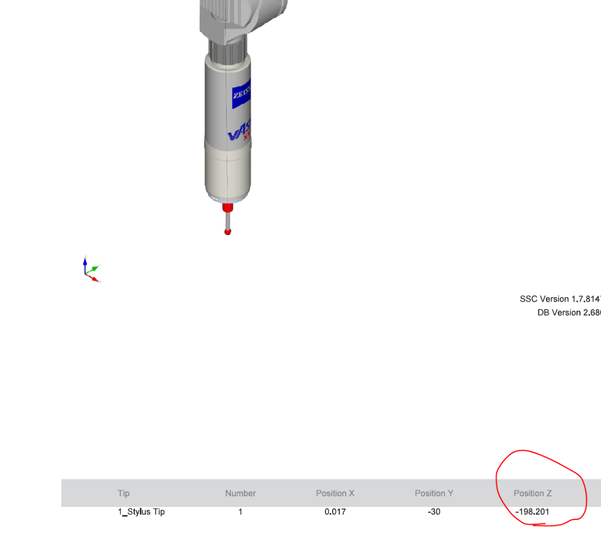

[Ji...] Posted May 7, 2025 Author Share Posted May 7, 2025 Then i checked the data for the styli as following: Link to comment Share on other sites More sharing options...

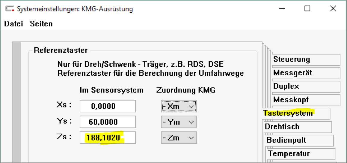

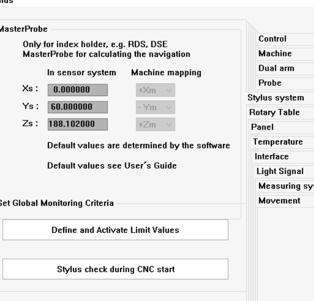

[Ma...] Posted May 7, 2025 Share Posted May 7, 2025 Hello JinXi, attached you find a manual for the RDS XXT Simulation, its a bit more complicated with the RDS then with a Vast Gold for example. XXT - Simulation with a RDS-VAST-XXT.doc With CALYPSO >2020 you need the following lengths for the Stylussystem Settings (in the manual is the Zs for the older Versions): Best Regards Marcel Link to comment Share on other sites More sharing options...

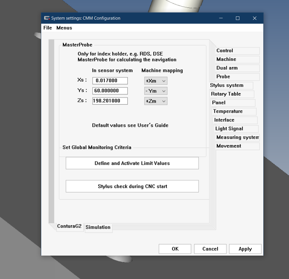

[Ji...] Posted May 7, 2025 Author Share Posted May 7, 2025 Please sign in to view this quote. Hi, Thank you! I set the Zs 188.1020, but it still not work. i set the data is from the info from the master probe. this data is corrected for styli #1, but once build another the styli(#2 ,#3), something is wrong. i don't know what's the wrong. Link to comment Share on other sites More sharing options...
[Je...] Posted May 7, 2025 Share Posted May 7, 2025 Easy to overlook - Make sure the diameter for your MasterProbe is correct and not set to 0 1 Link to comment Share on other sites More sharing options...
[Ri...] Posted May 7, 2025 Share Posted May 7, 2025 Please sign in to view this quote. Good point, that has caught me too many times. Link to comment Share on other sites More sharing options...
[Ji...] Posted May 8, 2025 Author Share Posted May 8, 2025 Please sign in to view this quote. Hi, i checked the diameter that's 2.5mm. it's ok. Attached are the SSC file. someone can help me find the reason. 😀 CZRefernztaster.ssc Kugel D1.ssc Link to comment Share on other sites More sharing options...
