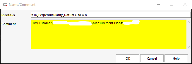

[Ri...] Posted May 7, 2025 Share Posted May 7, 2025 Please sign in to view this quote. I would probably just poor man it with putting a formula inside the comment of the first Characteristic. getActualInspectionDir() 1 Link to comment Share on other sites More sharing options...

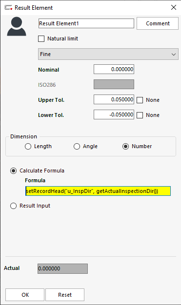

[Ri...] Posted May 7, 2025 Share Posted May 7, 2025 Please sign in to view this username. I guess it depends exactly what you are trying to doing, but absolutely you can change header parameters with PCM via the pre-settings or post-settings. You can try to do it via the comment section of a characteristic, or in the formula field of a ResultElement. setRecordHead("company", getActualInspectionDir()) This works. Link to comment Share on other sites More sharing options...

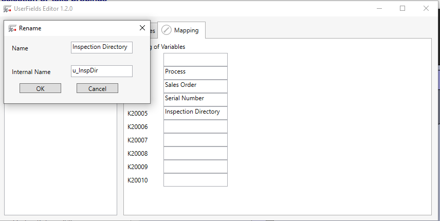

[Ri...] Posted May 7, 2025 Share Posted May 7, 2025 Please sign in to view this username. I just did testing where I created a new userfield for the Inspection Directory, and mapped it. Then in the formula of the Result Element I put this in the formula. It appears to work. 1 1 Link to comment Share on other sites More sharing options...
[Ma...] Posted May 7, 2025 Author Share Posted May 7, 2025 Please sign in to view this username. Thanks a lot!!! This seems to be final solution. I'll do some tests next week when i'll have spare time 🙂 Link to comment Share on other sites More sharing options...
[Ch...] Posted May 11, 2025 Share Posted May 11, 2025 Please sign in to view this username. Hi, I have a question. Do I need a license to use this mapping dialog box? I want to open it, but nothing appears. I don't know if I need to enable it somehow or contact Zeiss support. Link to comment Share on other sites More sharing options...
[Ma...] Posted May 13, 2025 Author Share Posted May 13, 2025 Please sign in to view this username. I have just noticed - once you use mapping, then you can not use "u_workdir" but you have to use that mapped K num. I've tried with result element - works. I'll try to hide it in condition or nominal formula - i am not sure for old protocols - perhaps tommorow i will have time. Please sign in to view this username. this should be without any license - just Calypso. What version of Calypso you have? Link to comment Share on other sites More sharing options...
[Ch...] Posted May 15, 2025 Share Posted May 15, 2025 Please sign in to view this username. version 2023,Apparently my employer had a block with a folder that activated that tool, it has been resolved, thank you very much for the help. 1 Link to comment Share on other sites More sharing options...
