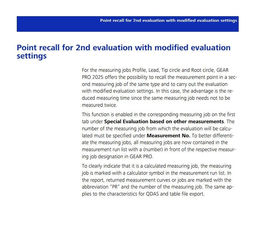

[Ch...] Posted Wednesday at 01:13 PM Share Posted Wednesday at 01:13 PM Just recently released on the portal ! Not much changed for Involute side it seems. Looks like they did get one of my MyVoice requests in though ... subsequent evaluations ... nice ! Thank you Zeiss Gear Pro team ! 1 Link to comment Share on other sites More sharing options...
[Ri...] Posted Wednesday at 01:37 PM Share Posted Wednesday at 01:37 PM Speaking of Subsequent Evaluation, has anyone been able to get it to push new data to Calypso if you perform a re-evaluation of the data? It always fails. 😞 Link to comment Share on other sites More sharing options...
