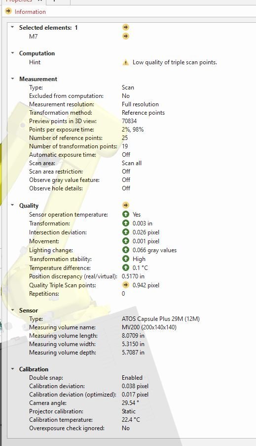

[Sh...] Posted May 7, 2025 Share Posted May 7, 2025 Hello, I am having the "Low quality of triple scan points" error appear in each and every shot that is taken using my 200mm measuring volume lenses on my Scan Box 5108. Rev 04 that we have been using since 2018. We typically use the 120mm measuring volume and we are using frames that were purchased with the system, for both measuring volumes. When I use the smaller volume, I hardly ever see this error but since I have switched to the larger measuring volume I'm seeing this error frequently. I have read quite a few topics in this forum but could not find anything that has fixed my issue. What I have done so far is, ran the calibration routine several times, I went through the Set Up process a couple of times, on my second set up I even checked my focus on all 3 lenses (Right, Left and Projector) and there was no adjustment required even though I did move the focus ring and I could not get any better values, I also switched out my holding fixture since it did seem a bit shiny compared to the frame, I have taken shots of just the frame to eliminate any reflectivity of the part I am trying to scan and I'm still seeing the error. I have tried different angles to reduce any reflectivity and that did not solve my issue. I did see this issue at the end of last week, so I switched the system back to the 120mm measuring volume and the system seemed to run fine without the "Low quality of triple scan points" error. Where am I going wrong with my issue? Are there any other things I can try? Thank you for your insights in advance Link to comment Share on other sites More sharing options...

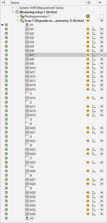

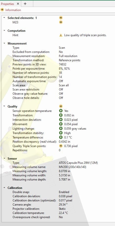

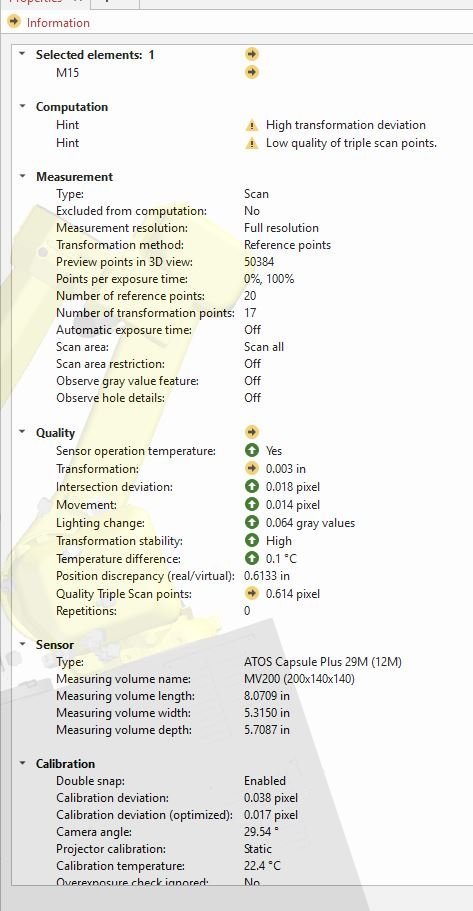

[Sh...] Posted May 9, 2025 Author Share Posted May 9, 2025 As posted earlier, a co-worker was using our system this morning set up with 120mm lenses, after he was done using the system today I loaded our larger frame, to be used with the 200mm lenses, and wrote a quick program with a couple of shots with the 120mm lenses, I did not see one triple scan point error both with a casting in the view and outside of the view. I'll attach 3 pictures showing the quality of the triple scan points and one of my overall program with 34 measurements all with the error. Link to comment Share on other sites More sharing options...
