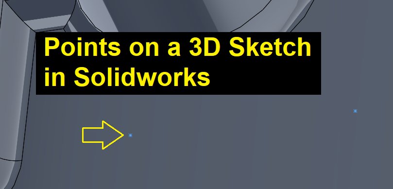

Engineers often provide Solidworks models for me that, besides the solid CAD bodies, have a 3D sketch of points (point set) that represent inspection points.  These are often provided for quick steel-to-CAD comparisons.

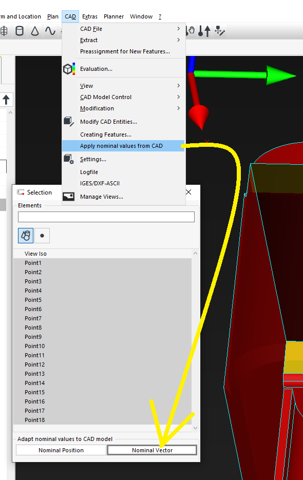

So far, I have been using a Solidworks macro to export the points from the sketch into Calypso as a .txt or .csv file.  Then, I use the CAD > "Apply Nominal Values from CAD" function to snap the points to the CAD and get their normal vectors (the solidworks macro doesn't do a great job of exporting correct vectors, since the points are just floating on a 3D sketch).

Snapping_Points_to_CAD_to_Assign_Vectors.thumb.png.df0f31c62e77bb63ee0a9814dd6953f0.png

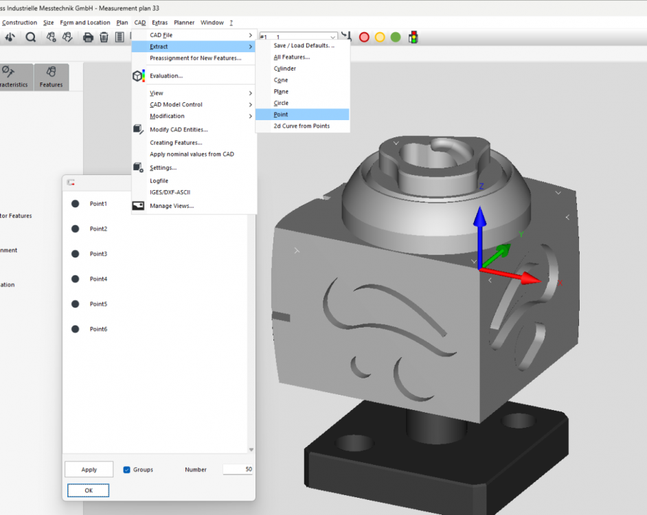

Hey Jeff, I use extract points usually in this case. Unless there is something elese I am missing in your post.
