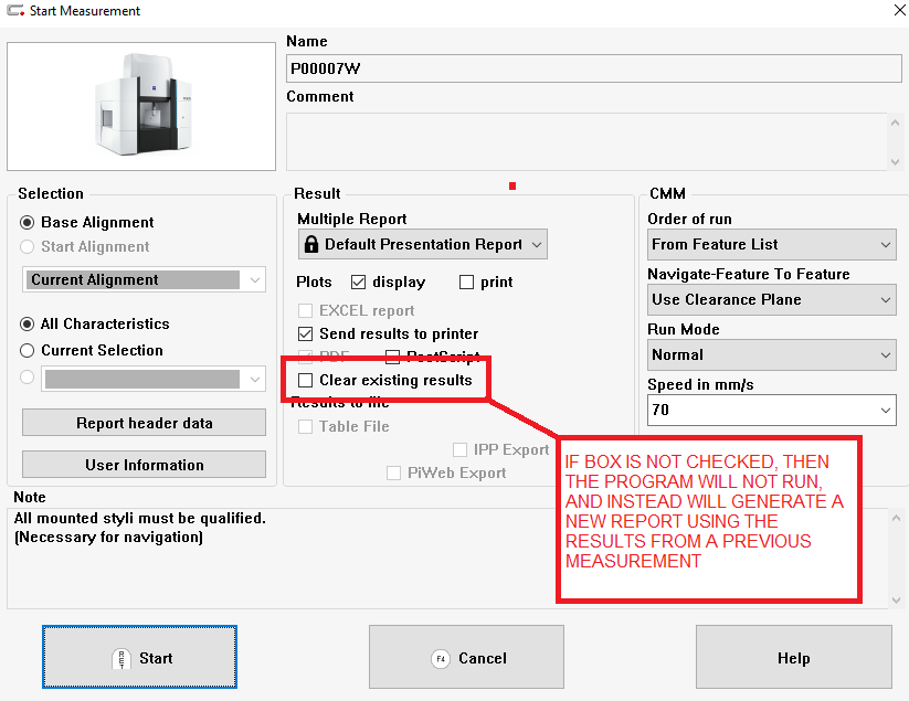

[Lu...] Posted May 8, 2025 Share Posted May 8, 2025 (edited) Do you want to edit the results of an already created PDF? Or just to create a new report using the new measurement data? If you want to make a new report, you can uncheck the "Clear existing results" checkbox that is there before you run the program, which will use the current measurement data and generate a new report without running the program over again. I also might be misunderstanding the question Edited May 8, 2025 Link to comment Share on other sites More sharing options...
[Se...] Posted May 9, 2025 Author Share Posted May 9, 2025 Please sign in to view this quote. Yes, that’s correct. We are using FOCS to run measurements connected with a conveyor system, so we do not keep the Calypso program open during measurement. Because of this, we use PCM to automatically re-measure a feature when an NOK result is detected during the process. I hope this makes sense. Link to comment Share on other sites More sharing options...
[Se...] Posted May 9, 2025 Author Share Posted May 9, 2025 Please sign in to view this quote. Thank you, but I think there's a misunderstanding. We are not trying to reprint the same results manually. We use FOCS + PCM to run fully automatic measurements. That means we don’t open Calypso manually, and the measurement runs in the background. When a characteristic result is NOK, we use PCM to automatically remeasure it until it becomes OK. However, in the final PDF report, it still shows the initial NOK value, not the updated OK value from remeasurement. So our goal is to make the PDF show the latest OK result without re-running the whole program manually. Link to comment Share on other sites More sharing options...

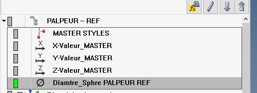

[Se...] Posted May 12, 2025 Author Share Posted May 12, 2025 Please sign in to view this quote. Hi, Yes, we are using FACS. For the automatic remeasure, we have tested several methods. Here is one example using PCM: ID = getActual("Sphre PALPEUR REF").diameter // Lower Tolerance if ID < 29.98871 then display(getActual("Sphre PALPEUR REF").diameter) message("Clean Probe") status = inquire("1=remeasure") if status == 1 measure("Sphre PALPEUR REF",1) endif endif // Upper Tolerance if ID > 29.99271 then display(getActual("Sphre PALPEUR REF").diameter) message("Clean Probe") status = inquire("1=remeasure") if status == 1 measure("Sphre PALPEUR REF",1) endif endif We are using PiWeb to display the results. Unfortunately, we couldn’t get any official solution from our ZEISS support team. Link to comment Share on other sites More sharing options...
[Se...] Posted May 12, 2025 Author Share Posted May 12, 2025 Please sign in to view this quote. Hi, We are currently using the following PCM code for remeasurement based on the diameter tolerance: ID = getActual("Sphre PALPEUR REF").diameter // Lower Tolerance if ID < 29.98871 then display(getActual("Sphre PALPEUR REF").diameter) message("Clean Probe") status = inquire("1=remeasure") if status == 1 measure("Sphre PALPEUR REF",1) endif endif // Upper Tolerance if ID > 29.99271 then display(getActual("Sphre PALPEUR REF").diameter) message("Clean Probe") status = inquire("1=remeasure") if status == 1 measure("Sphre PALPEUR REF",1) endif endif Do you know if there’s a better or more efficient way to handle this kind of automatic remeasure logic in Calypso? Any suggestion or alternative approach would be appreciated. Link to comment Share on other sites More sharing options...
