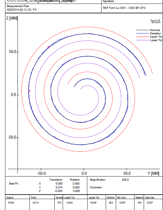

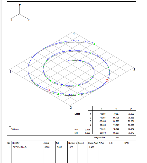

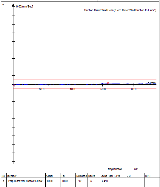

[Jo...] Posted May 8 Share Posted May 8 Good Morning all, I think it's safe to say that Piweb is taking over, Custom printout is a thing of the past or soon will be... I know the newer versions have a compatibility option, but I may attempt to get ahead of the custom printout phase-out by transitioning to Piweb. My company is very used to its current custom printout and the graphs that come with it. All machinists and floor operators, along with engineers, are used to seeing these graphs and the current report format. How can I easily add these graphs to the Piweb report? I really do not want to use the CAD presentation function to achieve this. I have tested this and it ended up bogging down the reporting as well as adding the tedious task of creating all these views. This is not a viable method due to the number of programs and CAD views that would need to be created. A given program could have 30+ Graphs. Appreciate any insight other users may have. Link to comment Share on other sites More sharing options...

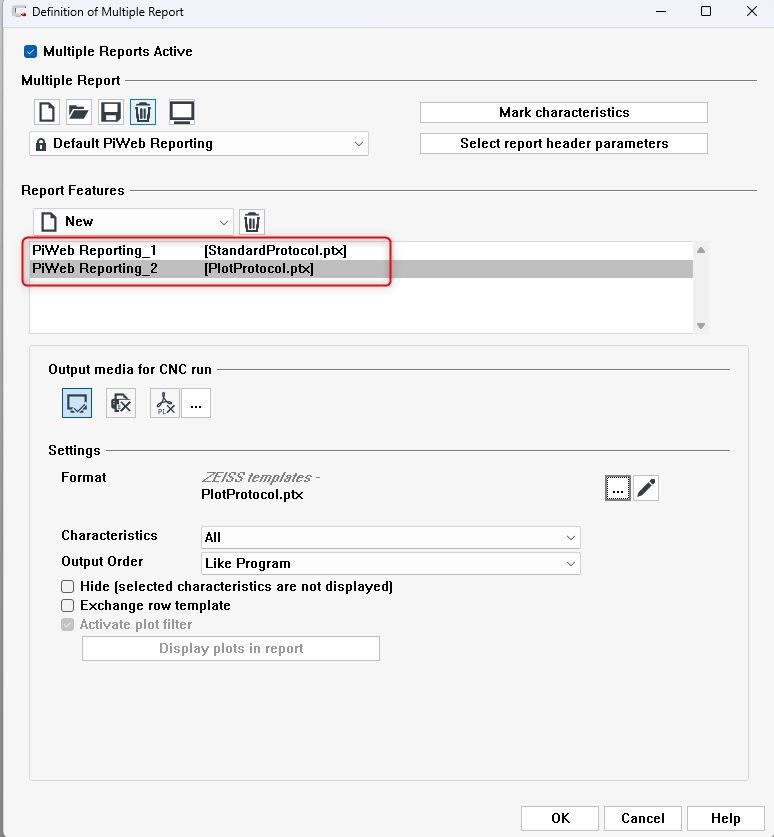

[An...] Posted May 8 Share Posted May 8 Hi Joseph, It looks to me like you are trying to achieve the result shown in this KB article: https://portal.zeiss.com/knowledge-base?id=523075 Alternatively, you may also want to try using the Plot Protocol alongside the Standard Protocol. 1 Link to comment Share on other sites More sharing options...

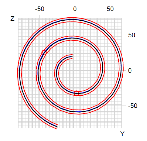

[Jo...] Posted May 12 Author Share Posted May 12 So I gave this a shot. Although it gave all the graphs it still isn't quite what I was looking for. The above custom printout graphs are dialed in for that feature. The graph below doesn't show the curve but in a smaller graph and attached to the characteristic. Is there a way to have all these graphs appear before or after all characteristics? Link to comment Share on other sites More sharing options...
[Do...] Posted November 19 Share Posted November 19 You can select multiple PiWeb reports. In this case, the numerical values are displayed in the StandardProtocol.ptx and the form plots are displayed in the PlotProtocol.ptx. Link to comment Share on other sites More sharing options...
