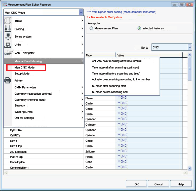

[Ja...] Posted May 8, 2025 Share Posted May 8, 2025 Hi all I have been asked to setup certain programs to be able to be ran on night shift by operators who have no experience on the Zeiss CMM. How do I lockdown the menus/programs to make them so they are 'set and go'. At the minute I have the 3D model open, and list of features and characteristics on the side, which can be easily 'clicked' into. Also, it only takes a click on the model, and it extracts a feature which the CMM will try and measure. Literally want it to be 'idiot' proof so to speak - run a proven program and that's it. Thank you Jack Link to comment Share on other sites More sharing options...
[Cl...] Posted May 8, 2025 Share Posted May 8, 2025 Place the programs in autorun. with the permissions set for the operator just run the program. 1 Link to comment Share on other sites More sharing options...
[DW...] Posted May 8, 2025 Share Posted May 8, 2025 Please sign in to view this quote. Please sign in to view this username. Autorun is your friend here but I am more alarmed that your company is risking tens of thousands of dollars in CMM damage with wholly untrained operators. I do not like Autorun (but it definitely has it's purpose) because I want everyone to be able to see what's happening behind the scenes. At my last job, I set the permissions for each shift so they could see all the features and characteristics etc, but had no permissions to save anything if they did happen to change something. 1 Link to comment Share on other sites More sharing options...

[Ja...] Posted May 15, 2025 Author Share Posted May 15, 2025 Appreciate the PDF guides gents, big help. I've got something set up, just sorting the privileges out for the users. Just a quick question, is there a way I can make manual alignment permanently ticked? So basically when Operator clicks 'Run' - its straight away asks for the alignment? Also how do people simplify alignments in autorun? I've never really looked into table co-ordinate systems/pallets etc. As you can guess I'm really trying to simplify this. Open user information for setup, click run and then simple alignment. Thanks so far for the help again all, appreciated as always. Link to comment Share on other sites More sharing options...
[na...] Posted May 15, 2025 Share Posted May 15, 2025 Please sign in to view this quote. Dedicated fixtures and start alignment with only 1 point if possible. 1 Link to comment Share on other sites More sharing options...
[Ja...] Posted May 15, 2025 Author Share Posted May 15, 2025 I know on other CMM's we have set up alignments which instruct the operator to move the probe to the centre of the part, press okay - the machine then pulls the XYZ position from the system, and from that we create a theoretical point, origin XYZ, creating an initial 'datum'. The machine then goes into CNC mode and measures the plane, circle etc relative to that initial 'theoretical point'. So all the operator is doing is moving the probe into position and hitting okay. Can this be replicated in Calypso? Link to comment Share on other sites More sharing options...
[Ma...] Posted May 15, 2025 Share Posted May 15, 2025 Please sign in to view this username. If you really need on every start to do manual alignment, then change your features to be manually measured - ideally if it's on start alignment. Otherwise i think you can not force that to be checked all the time. I observed that on all our pallet programs you can not either check manual alignment in autorun. Also i remember that on definition of alignment you can check "manual alignment"- not sure how that works. Link to comment Share on other sites More sharing options...
[Ja...] Posted May 15, 2025 Author Share Posted May 15, 2025 Please sign in to view this username. there's no choice at the moment, we have a variety of parts that go on and no permanent set positioning for the fixtures, so the machine won't know exactly where the part is each time its taken off. Calibration is another one.....Sphere needs referencing with master every time, whereas on other CMM machines, we have a 'fixed' position on the CMM which is stored in a subprogram, that is loaded so that when a calibration cycle is ran, the probes no exactly where the reference sphere is positioned. Link to comment Share on other sites More sharing options...

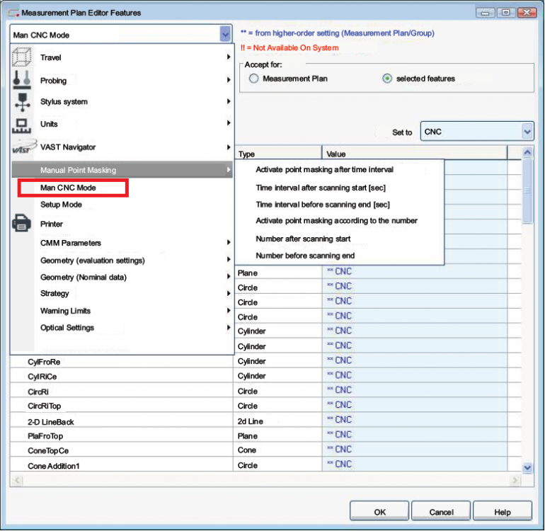

[Ma...] Posted May 15, 2025 Share Posted May 15, 2025 Please sign in to view this username. Then the only option would be editing programs to use start alignment where features will be touched manually by going to "Resources ➝ Measurement Plan Editor Features" -> Man CNC mode and selecting features to be done by MAN - it will always ask for manual probing. 1 Link to comment Share on other sites More sharing options...
