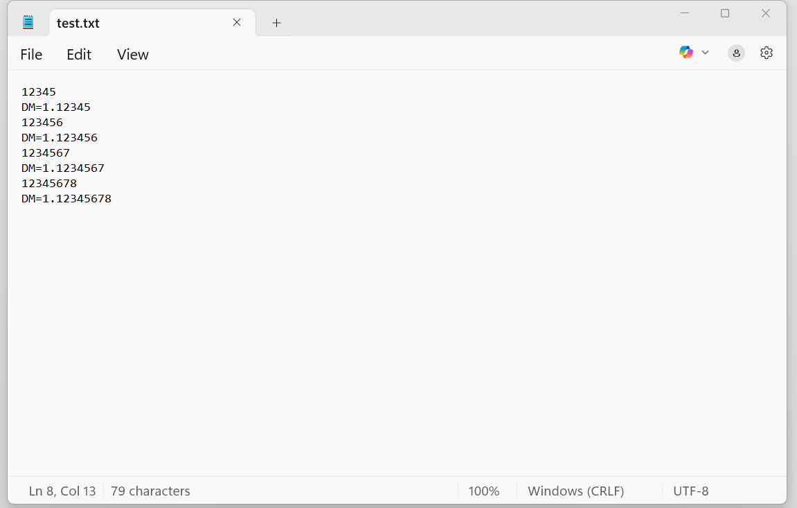

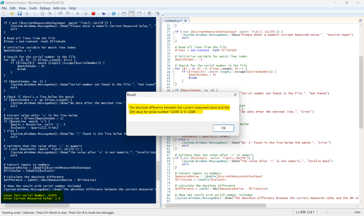

[DW...] Posted May 14 Share Posted May 14 Please sign in to view this quote. Please sign in to view this username. Make a plain text file on your desktop. Rename it to test.txt. Inside your para file, I am assuming your list looks like my snippet of inside my test.txt file. Go to your Windows search (the magnifying glass) on your taskbar. Type in "ISE". The first thing that should come up is Microsoft PowerShell ISE. Right click, open as Administrator (if you can). Copy and paste this script into the ISE workspace. Adjust the file path at the top to YOUR test.txt location. Hit F5 or the green "Run Script" button at the top. Follow prompts. Adjust this as necessary to fit your application. # Path to your text file $filePath = "C:\PATH TO YOUR TEXT FILE\test.txt" # Prompt user for Part Serial Number $serialNumber = Read-Host "Enter Part Serial Number" if ([string]::IsNullOrWhiteSpace($serialNumber)) { [System.Windows.MessageBox]::Show("No input provided for Serial Number.", "Error") exit } # Check if the serial number is numeric if (-not ($serialNumber -match '^\d+(\.\d+)?$')) { [System.Windows.MessageBox]::Show("Please enter a numeric serial number.", "Invalid Input") exit } # Prompt user for Current Measured Value $currentMeasuredValueInput = Read-Host "Enter Current Measured Value" # Validate the current measured value input if ([string]::IsNullOrWhiteSpace($currentMeasuredValueInput)) { [System.Windows.MessageBox]::Show("No input provided for Current Measured Value.", "Error") exit } if (-not ($currentMeasuredValueInput -match '^\d+(\.\d+)?$')) { [System.Windows.MessageBox]::Show("Please enter a numeric Current Measured Value.", "Invalid Input") exit } # Read all lines from the file $lines = Get-Content -Path $filePath # Initialize variable for match line index $matchIndex = -1 # Search for the serial number in the file for ($i = 0; $i -lt $lines.Length; $i++) { if ($lines[$i] -match [regex]::Escape($serialNumber)) { $matchIndex = $i break } } if ($matchIndex -eq -1) { [System.Windows.MessageBox]::Show("Serial number not found in the file.", "Not Found") exit } # Check if there's a line below the match if ($matchIndex + 1 -ge $lines.Length) { [System.Windows.MessageBox]::Show("No data after the matched line.", "Error") exit } # Extract value after '=' in the line below $nextLine = $lines[$matchIndex + 1] if ($nextLine -match '=') { $parts = $nextLine -split '=', 2 $valueStr = $parts[1].Trim() } else { [System.Windows.MessageBox]::Show("No '=' found in the line below the match.", "Error") exit } # Validate that the value after '=' is numeric if (-not ($valueStr -match '^\d+(\.\d+)?$')) { [System.Windows.MessageBox]::Show("The value after '=' is not numeric.", "Invalid Data") exit } # Convert inputs to numbers $measuredValue = [double]$currentMeasuredValueInput $fileValue = [double]$valueStr # Calculate the absolute difference $difference = [math]::Abs($measuredValue - $fileValue) # Show the result with serial number included [System.Windows.MessageBox]::Show("The absolute difference between the current measured value and the DM value for serial number '$serialNumber' is '$difference'.", "Result") 2 Link to comment Share on other sites More sharing options...

[Ry...] Posted May 14 Author Share Posted May 14 Please sign in to view this quote. Thank you for writing this it is working perfectly. I had to adjust it only slightly since the data base had a few extra bits of information. Thank you again for your help 1 Link to comment Share on other sites More sharing options...
