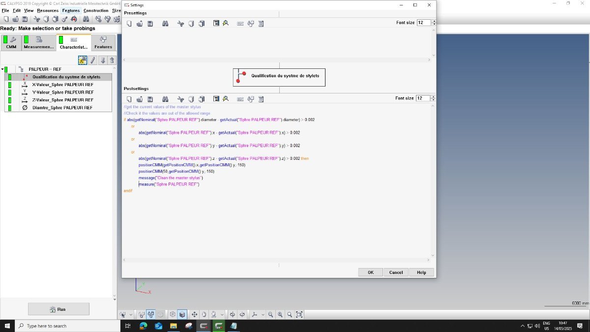

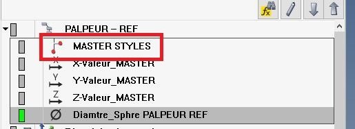

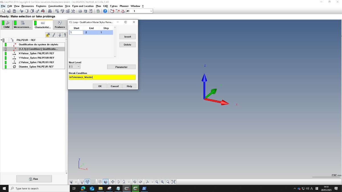

[Se...] Posted Tuesday at 06:42 AM Share Posted Tuesday at 06:42 AM Is there a PCM command to run a characteristic like stylus qualification? I’m referring to the characteristic shown in the red box in the picture. Link to comment Share on other sites More sharing options...
[Ch...] Posted Tuesday at 06:07 PM Share Posted Tuesday at 06:07 PM (edited) yes , but even easier should be a "mini-plan" some PCM that would help are : measure() addCF() measure() is for Features or ME / Measurement Elements only not Characteristics. I tried a few things , no dice. I wuold say easiest way to go here is a mini-plan then you can use PCM with SetRUNID() etc. Good luck. Edited Tuesday at 06:33 PM Link to comment Share on other sites More sharing options...

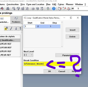

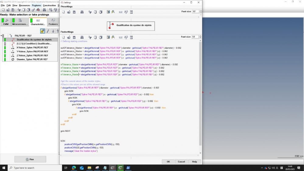

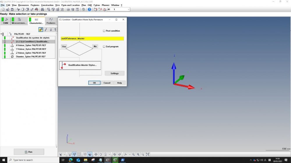

[Se...] Posted yesterday at 01:59 AM Author Share Posted yesterday at 01:59 AM Hello, Chris Please check the attached screenshot first. I am creating a stylus qualification program. First, I qualify the stylus and then measure the sphere. Then, I check how much the measured result is shifted from the nominal sphere center. If the result is out of tolerance, the program shows a message to clean the probe and remeasures the sphere. This part works correctly. The problem is: I also want to remeasure the qualification characteristic, but I don’t know how. I want the qualification characteristic to be remeasured after the probe is requalified. Is it possible to do this using setRunID? Or is there another way? Thank you in advance for your help. Link to comment Share on other sites More sharing options...

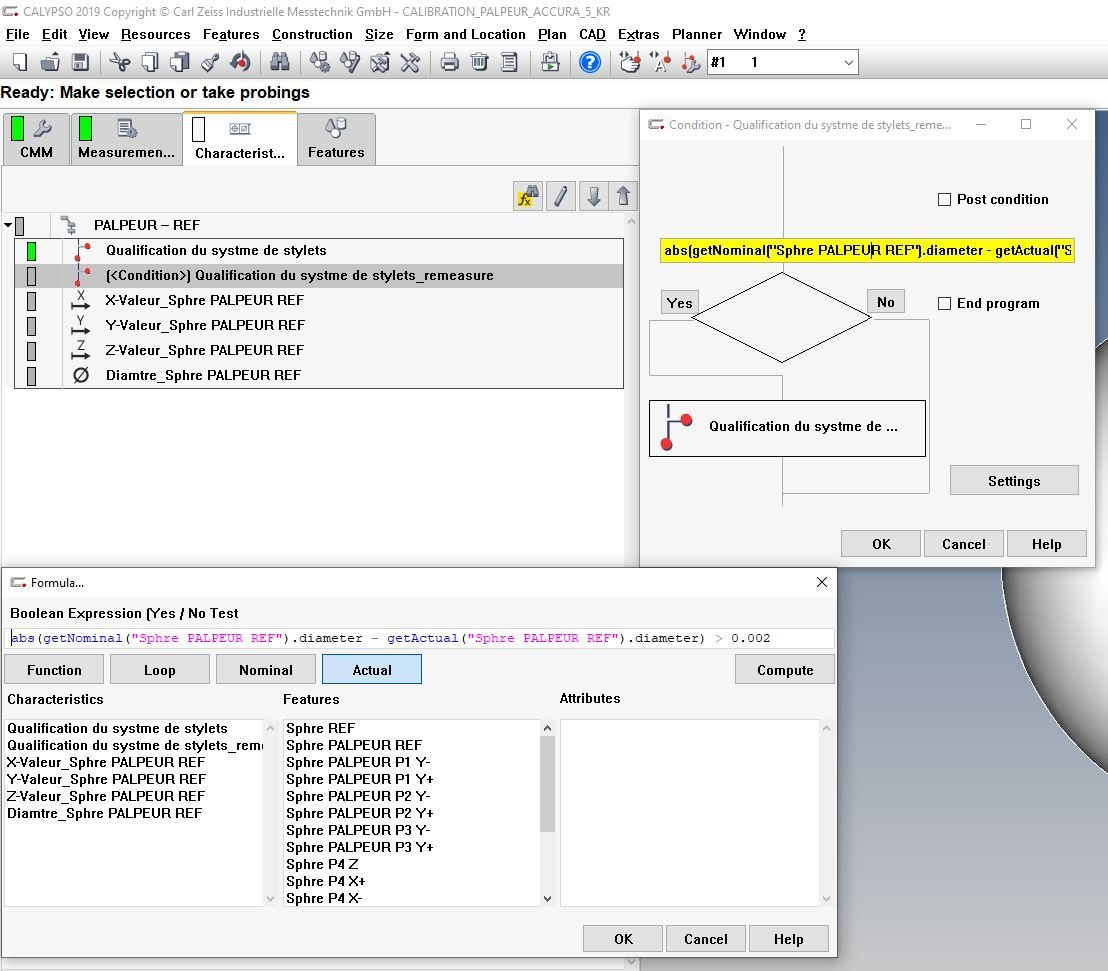

[Ch...] Posted 14 hours ago Share Posted 14 hours ago (edited) question : do you run from characteristics list instead of features ? - so the Probe Qual is done first, correct ? In theory , you could add 2 probe qualifications, the second one could have a 'condition' set on it if one of the characteristics is ".outOfTolerance" to remeasure. Im testing offline even running from characteristics, it runs the sphere before running the 1st probe qual .. Edited 14 hours ago Link to comment Share on other sites More sharing options...

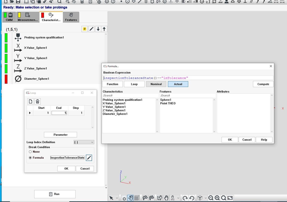

[Ch...] Posted 14 hours ago Share Posted 14 hours ago Another thing I was thinking is the group you have you can put a LOOP on and have a parameter / formula for that. Although I'm not seeing a way with PCM to test if a "group" is inTolerance or outOfTolerance, that would be one easy way. I'd suggest reaching out to Zeiss team. Please sign in to view this username. any help on this one? Thanks ! Link to comment Share on other sites More sharing options...

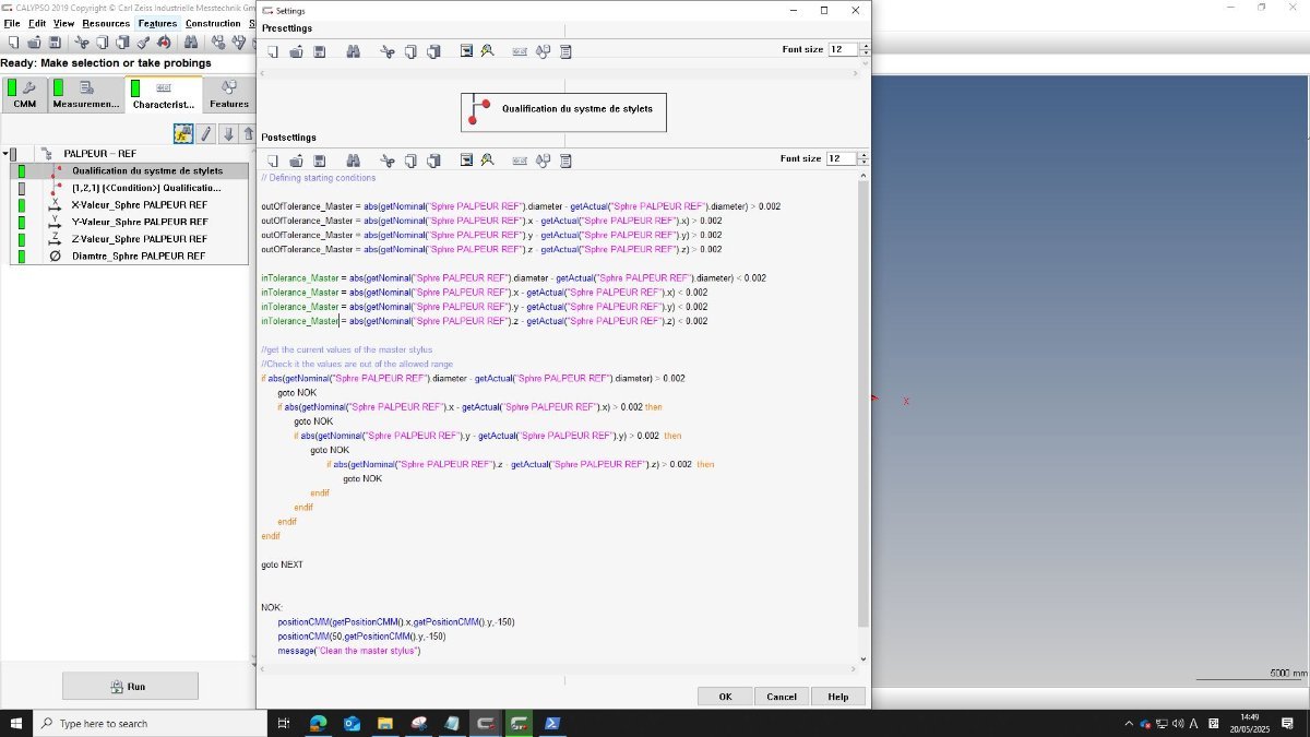

[Se...] Posted 6 hours ago Author Share Posted 6 hours ago Please sign in to view this quote. Yes, I am running the measurement from the characteristics list. First, the stylus qualification is done, and then the reference sphere is measured. I added PCM to the stylus qualification characteristic. Link to comment Share on other sites More sharing options...
[Se...] Posted 6 hours ago Author Share Posted 6 hours ago Please sign in to view this quote. Yes, that's right I really want to solve this issue. Thank you so much for your help! Link to comment Share on other sites More sharing options...
