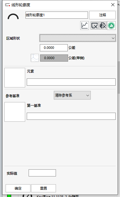

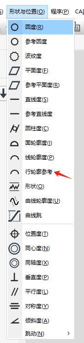

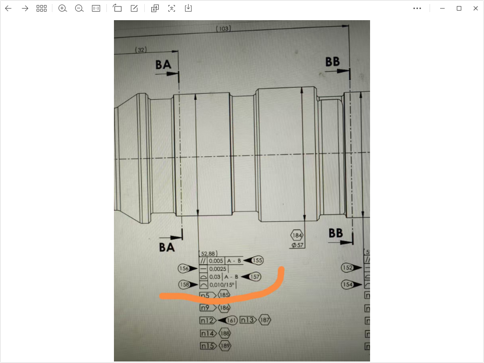

[ji...] Posted May 16, 2025 Share Posted May 16, 2025 Hello everyone! I'd like to ask you how to measure this surface profile with ZEISS CMM, how to label the tolerance zone properly, how to take this line and where to take it. Link to comment Share on other sites More sharing options...
[Ma...] Posted May 16, 2025 Share Posted May 16, 2025 I am waiting for this option too, but i have an old version of Calypso - perhaps 2023+ should be able to this. Otherwise i have been told to make segments manually. I saw this option only on flatness ref. Link to comment Share on other sites More sharing options...
[ji...] Posted May 16, 2025 Author Share Posted May 16, 2025 Please sign in to view this quote. I have this feature, but I don't know how to get it to use Link to comment Share on other sites More sharing options...
[Ma...] Posted May 16, 2025 Share Posted May 16, 2025 Well since it's in CN(?) i don't know what's written there - but GTranslate said something which is possibly pointing that this second one line profile is what you looking for. Your initial picture of characteristic is showing the upper one, so i have no idea how that window look like. Link to comment Share on other sites More sharing options...
[De...] Posted May 29, 2025 Share Posted May 29, 2025 I would say make a cross section, but there needs to be a basic dimension the defines that location. Link to comment Share on other sites More sharing options...
