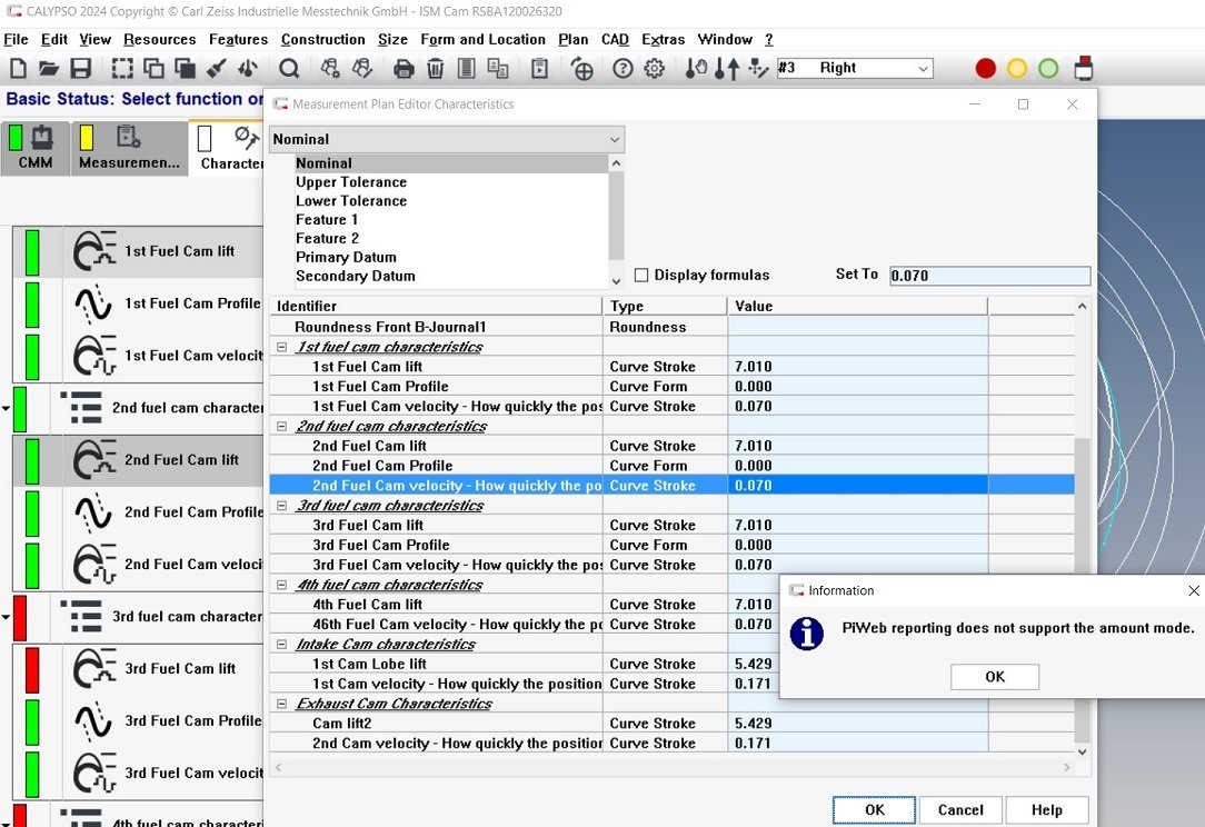

[Ow...] Posted May 16, 2025 Share Posted May 16, 2025 This may be a redundant question as I use just the basic version of PiWeb, but has anybody else noticed this? Currently running 7.8.08. Another question regarding curve (sorry not right place to post but, time is limited), every time I bring in a 2D curve feature it says " nominal points are not exactly arranged in a plane"? Link to comment Share on other sites More sharing options...

[An...] Posted May 16, 2025 Share Posted May 16, 2025 For the PiWeb message, see : 2 Link to comment Share on other sites More sharing options...
[Ow...] Posted May 16, 2025 Author Share Posted May 16, 2025 Please sign in to view this quote. Restart didn't fix the PiWeb issue but Andy Block's post fixed that. I'm not sure how it got changed to "amount mode" , but selecting number scale fixed it :-). Modifying the nominals with the constant value in the coordinate axis direction fixed the " nominal points are not exactly arranged in a plane" error. I don't have a model, that's why I digitized it. I do have drawing showing the cam nominals and vectors and what I digitized is very close. When digitizing a involute type of curve and other small features, using a very very slow scanning speed of 0.3 or less is critical to getting good results. When I get back to working in my office, I'll create the cad model, I just didn't have the time for this little one-on, one-off R&D project. I couldn't edit my original post but, the amount the Y axis nominals differed from each other was less than 0.010 (not 0.1) and again, I don't ever remember Calypso giving that pop-up error and I believe this is the first curve I've digitized since loading Calypso version 2024 back in December. Link to comment Share on other sites More sharing options...

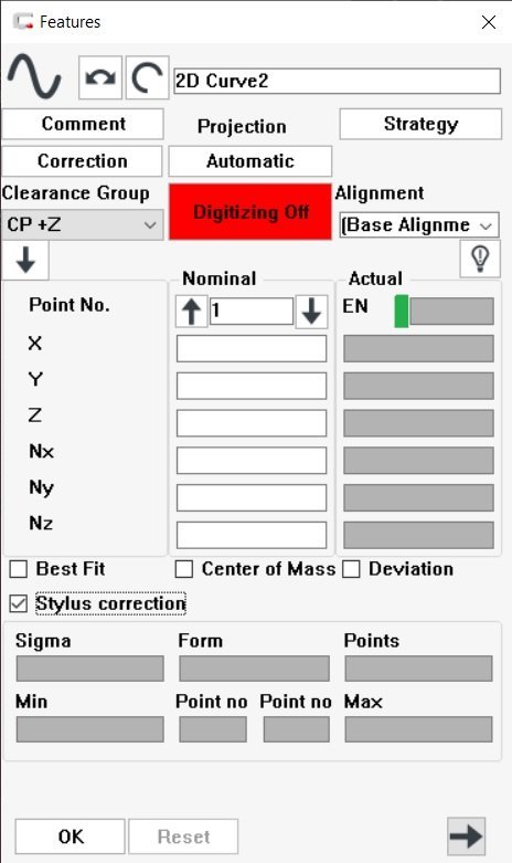

[Ow...] Posted May 28, 2025 Author Share Posted May 28, 2025 (edited) Please sign in to view this quote. Martin Jánský, I was in a hurry in my last post (was focused on a 10 day vacation) and didn't exactly address the "offset of the curve for the probe" issue you said you were having. The only problem I recall having back when you had to correct them for probe radius was that sometimes it would flip a few vectors and offset the nominal in the opposite direction. That may have been caused by having too many vectors close together (?), I can't remember. In newer versions of calypso, after selecting to digitize, a check box appears for stylus correction and it has always worked for me. Edited May 28, 2025 Link to comment Share on other sites More sharing options...
