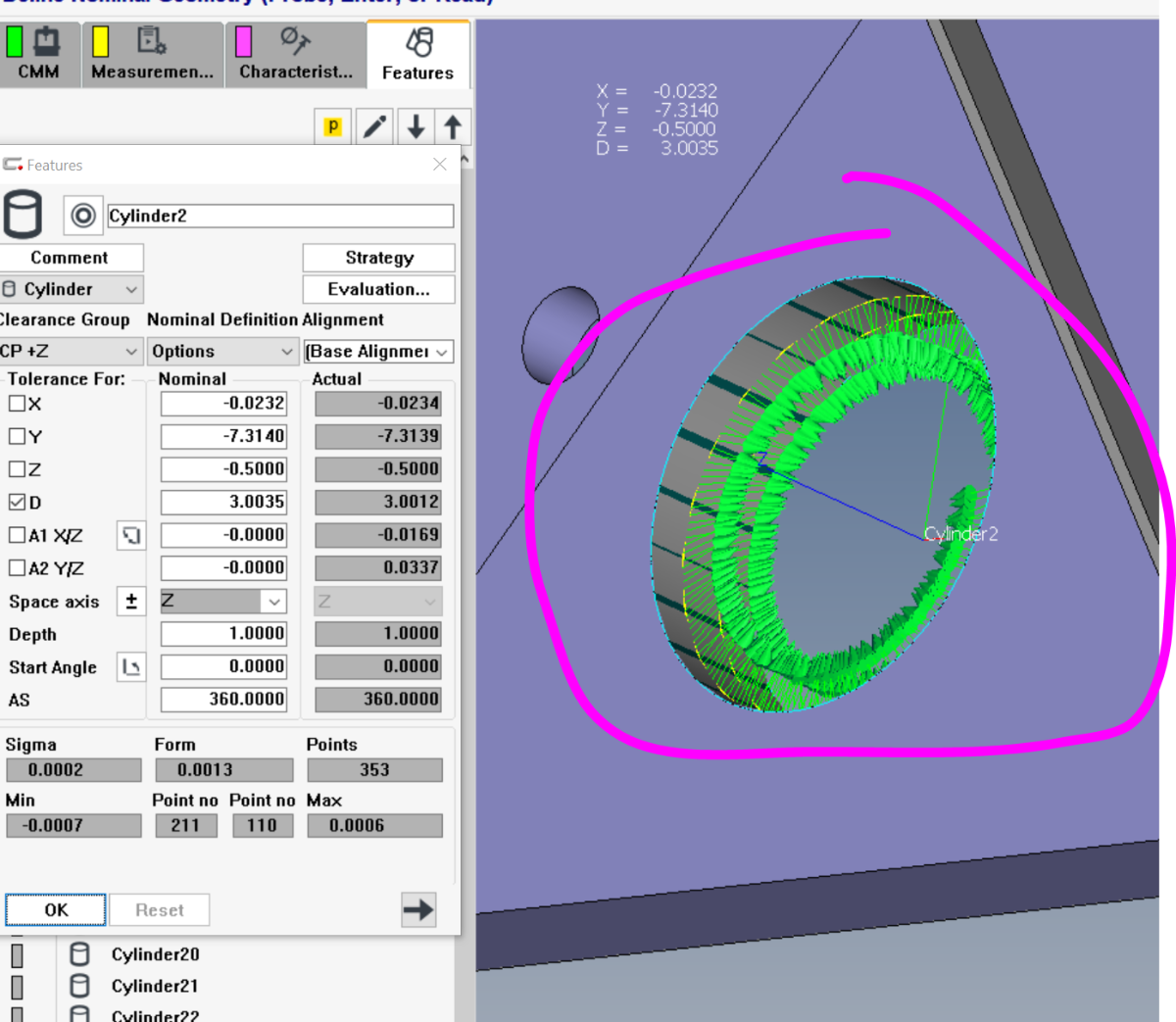

[Ra...] Posted May 16, 2025 Share Posted May 16, 2025 Hello, I'm using Calypso 2022, the machine is spectrum. "Do any of you know why this feature has a different color, as shown in the pictures?" Green and blue. Link to comment Share on other sites More sharing options...
[Ma...] Posted May 16, 2025 Share Posted May 16, 2025 Those colors can be edited in CAD -> Settings menu as feature color i believe. It's settings from program, so each programs can have different scheme Link to comment Share on other sites More sharing options...
[Ca...] Posted May 16, 2025 Share Posted May 16, 2025 Ramiro - Are you talking about what looks like stripes? It could be that it's seeing a feature on top of the CAD surface. You can combine the two using CAD Model Comparison. Step by step can be found here, starting on step 5: https://portal.zeiss.com/knowledge-base?id=446990 Link to comment Share on other sites More sharing options...
[Ca...] Posted May 16, 2025 Share Posted May 16, 2025 Maybe heal the model. Link to comment Share on other sites More sharing options...
