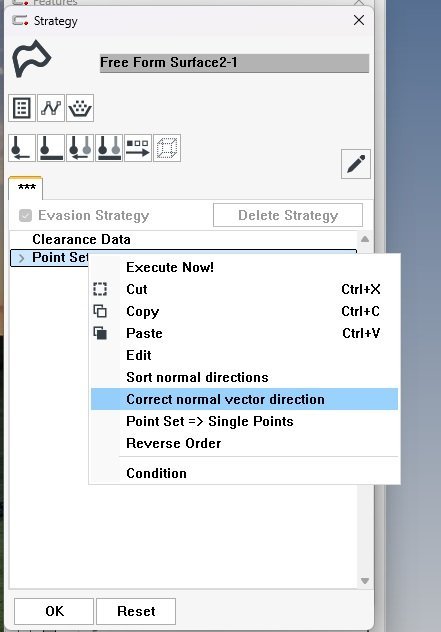

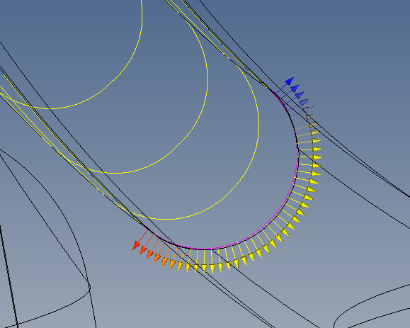

[Ri...] Posted May 19, 2025 Share Posted May 19, 2025 (edited) Never had this happen before. I create a Section for a FreeForm curve, for some reason a few places the vector direction is 180°off. These are arcs (Ø.106), they are on a 22.5° angle while rotating 42°. I can't show a print or model. As an example, if I create circle, I can click a button for OD or ID. Is there something similar for FreeForm curves? Curve vectors should be 180° from shown (as in an ID). Edited May 19, 2025 Link to comment Share on other sites More sharing options...
[Ri...] Posted May 19, 2025 Author Share Posted May 19, 2025 I found it. hahaha 2 Link to comment Share on other sites More sharing options...
[Ri...] Posted May 20, 2025 Author Share Posted May 20, 2025 For anyone who doesn't know. (Besides me 😄) 1 Link to comment Share on other sites More sharing options...
