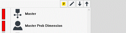

[Lo...] Posted Monday at 03:27 PM Share Posted Monday at 03:27 PM Hello everyone, I have a few days to "play" on the CMM boss is gone. I been wanting to write a probe program. I have one that was written for me but want to learn for myself. For the most have one running smoothly. Other than the Master probe is red and when I do a Results Element is comes up red and the numbers are 9999.9999 on a 8MM probe. Obliviously when qualifying with this program the I don't get error. But my other probes qualify fine without errors. What am I missing from this? Thanks for any info. Lou Link to comment Share on other sites More sharing options...
[Cl...] Posted Monday at 04:37 PM Share Posted Monday at 04:37 PM (edited) Are you speaking about the sigma value result element? Make sure syntax is correct and matches the stylus system and stylus exactly. getProbe("Down","0.7mm").stdProbeDev/25.4 Edited Monday at 04:40 PM 1 Link to comment Share on other sites More sharing options...
[Lo...] Posted Monday at 04:53 PM Author Share Posted Monday at 04:53 PM Please sign in to view this quote. Even before the results element. When I qualified the master probe, it fails qualification being red, I guess. But my other probe come out green, passing qualification. But the master probe will pass when I qualify it out of the program. Link to comment Share on other sites More sharing options...

[Lo...] Posted 13 hours ago Author Share Posted 13 hours ago Please sign in to view this quote. I was using clearance planes and position points only fixed that. I have a program written by someone else and they used clearance planes just not sure what they did differently and haven't heard back from them. Thanks! Link to comment Share on other sites More sharing options...
[An...] Posted 12 hours ago Share Posted 12 hours ago Typically if you are getting a bunch of 99999s in a formula/result element just means the syntax is wrong or reading in a non-existing value. Here is a link to our result element variables for styli. I would double check your syntax. Sometimes the wrong caps or a missed period could be causing the issue. https://portal.zeiss.com/knowledge-base?id=522752 Link to comment Share on other sites More sharing options...
