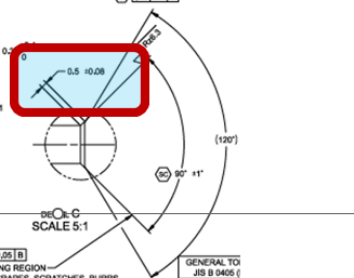

[Ko...] Posted May 19, 2025 Share Posted May 19, 2025 Hello everyone, I need your help in order to measure the length of a side of a cone. I received a new drawing from the customer and there is a 0.5mm length call out which is from the intersection of the through hole and a 90° angle to the intersection of the 120° angle and the 90° angle as you can see on the drawing. Thank you in advance Link to comment Share on other sites More sharing options...
[Ri...] Posted May 30, 2025 Share Posted May 30, 2025 Try this, create a Cone calculation from the cone to the top surface, select "Shell" for the cone. Then create another cone calculation from the cone to the cylinder, select "Shell" for the cone. Insert a Caliper Distance and select both of the cone calculations, set them too "maximum". There should be an option to measure distance with "3d". Link to comment Share on other sites More sharing options...
