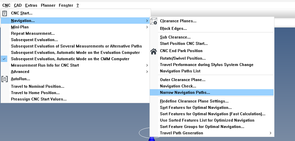

[Ma...] Posted May 29, 2025 Share Posted May 29, 2025 A simple and safe fix would be to block edges in Plan/ Navigation/ Block Edges. Block the movement around the x and y axis and leave Z open. This will force all CP movement to the Z clearance plane. Link to comment Share on other sites More sharing options...
[Ma...] Posted June 4, 2025 Share Posted June 4, 2025 Hi, as you stated correctly the 100mm is the default value and only should be changed if you know exactly why you are doing it (since its a global setting). It is a safety feature for the "quill" of the Z-Axis! You can activate the "Narrow Navigation Paths" Or use the solution that Please sign in to view this username. mentioned above. Best Regards Marcel Link to comment Share on other sites More sharing options...
