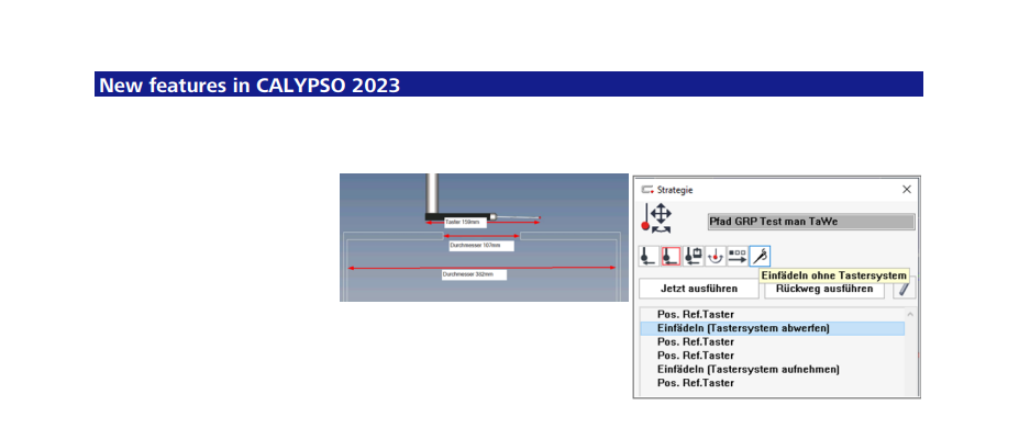

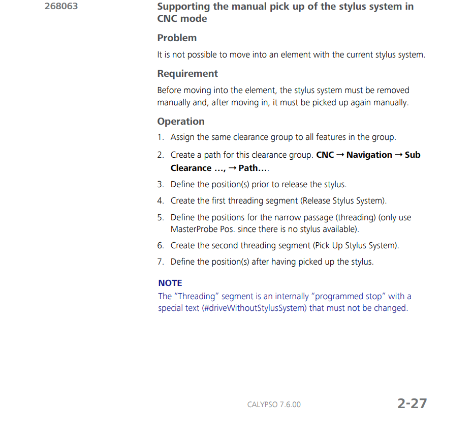

[Ke...] Posted June 6, 2025 Share Posted June 6, 2025 A bit late to the party, but a functionality to do exactly this-have the operator insert a probe manually for reasons for clearance or access, was added in Calypso 2024, in case that is the version you are utilizing or are able to move to. 1 Link to comment Share on other sites More sharing options...
[Ma...] Posted June 6, 2025 Share Posted June 6, 2025 (edited) Please sign in to view this username. Can you post how it's done? Anyways thanks for the info, i'll look into manual for that. Edited June 6, 2025 Link to comment Share on other sites More sharing options...
[Ke...] Posted June 6, 2025 Share Posted June 6, 2025 Please sign in to view this username. My apologies, it appears that time has once again gotten away from me, this feature was added in Calypso 2023. Basic information on this can be found in the release notes in the New Features section (page 2-27 in the English version). I would expect that more information could also be found in the Calypso built in helpfile (accessed through hitting F1 on the keyboard) but I do not have my system open to verify this. Attached is a screenshot from the release notes 1 1 Link to comment Share on other sites More sharing options...
