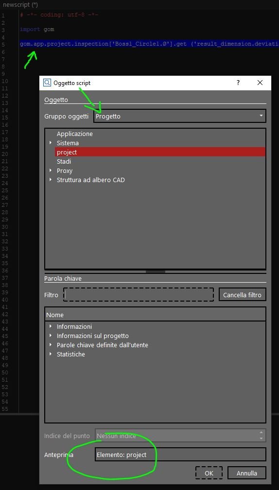

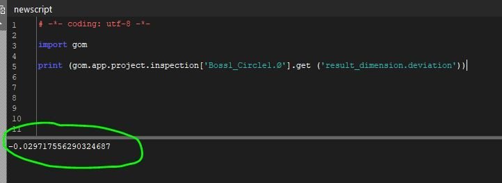

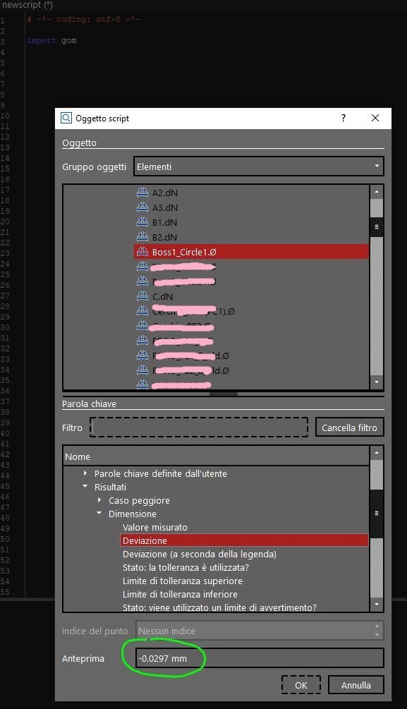

[An...] Posted May 26, 2025 Share Posted May 26, 2025 (edited) I encounter a problem in the script environment, when I query an item to recall a numeric value (with the Script Object function by pressing F2), a line is generated and I see the preview of the value I am recalling. If I press F2 again on that line, in the Script Object window I no longer see anything, but it returns to the starting point of the item choice. I have been working with it for 12 years and with the old versions it did not happen. If I try to print the item the value is recalled, but in the development phase it is a big limit if you write 1000 lines of code. I program a lot with python, and this function is necessary to check what I am exporting. Attached is a screenshot of the problem. Screen 1: inserting item by pressing F2 Screen 2: checking item, second press F2 on the line Screen 3: Printing the value Thanks Antonio Edited May 26, 2025 Link to comment Share on other sites More sharing options...

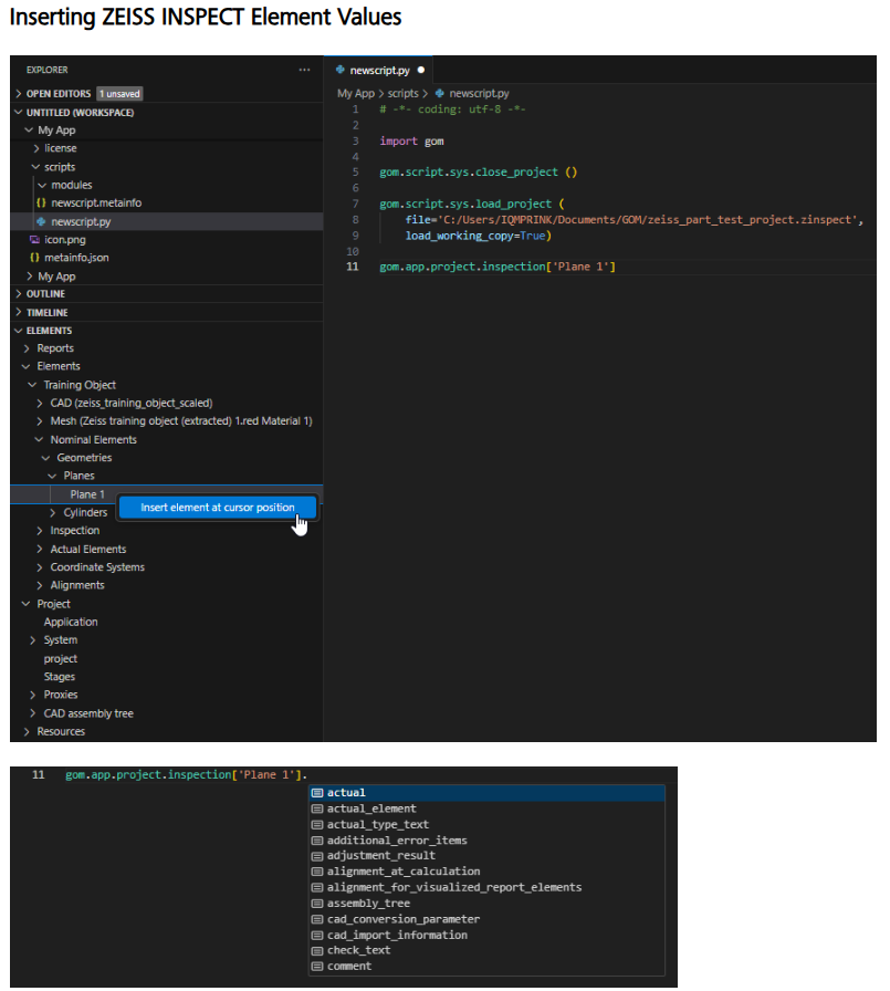

[Na...] Posted June 25, 2025 Share Posted June 25, 2025 Hello Antonio, the issue was created but I can't say when of if this will be changed. Maybe a different approach works for you by using VS Code as editor: https://zeiss.github.io/zeiss-inspect-app-api/2025/howtos/using_vscode_editor/using_vscode_editor.html Please sign in to view this quote. It has other benefits if you are working with large scripts. Nanno Link to comment Share on other sites More sharing options...
