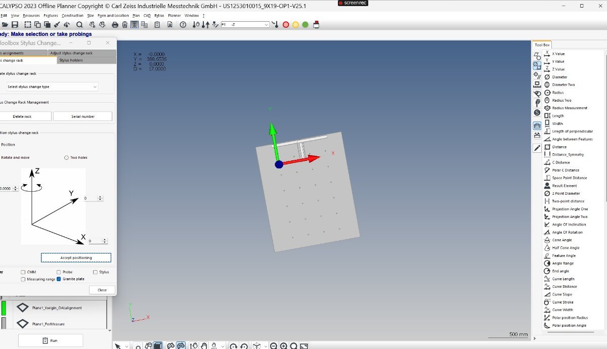

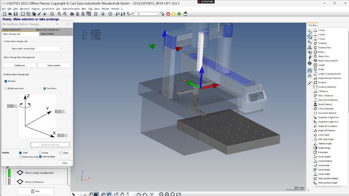

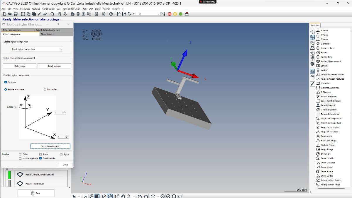

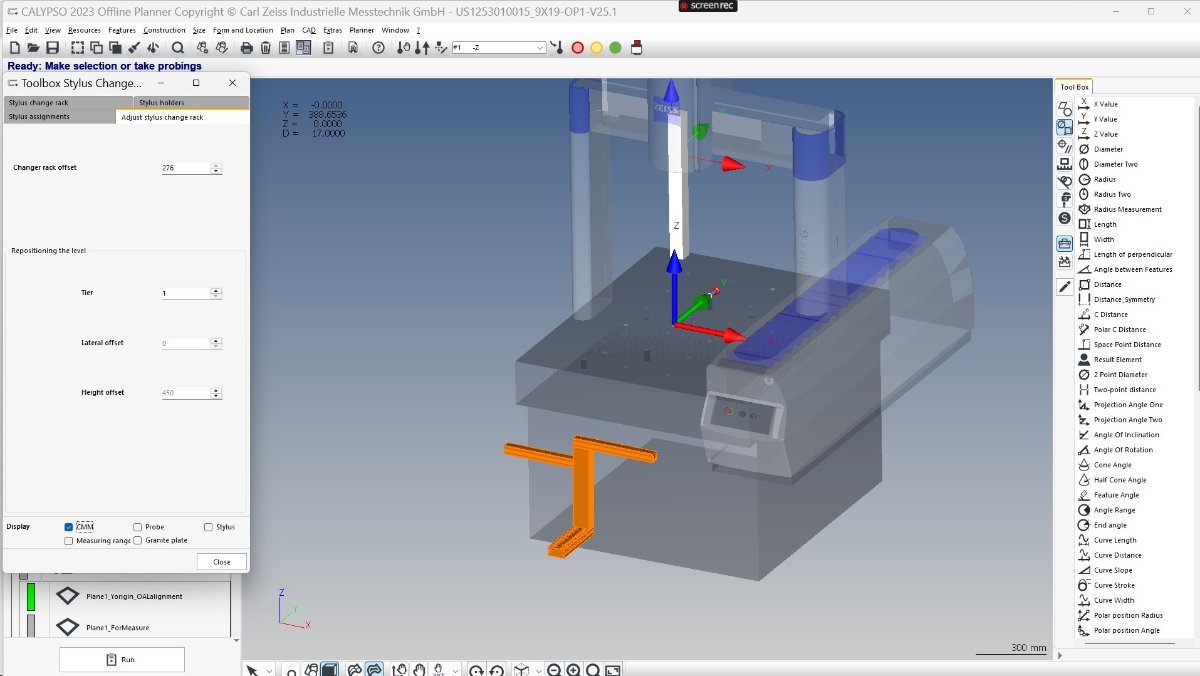

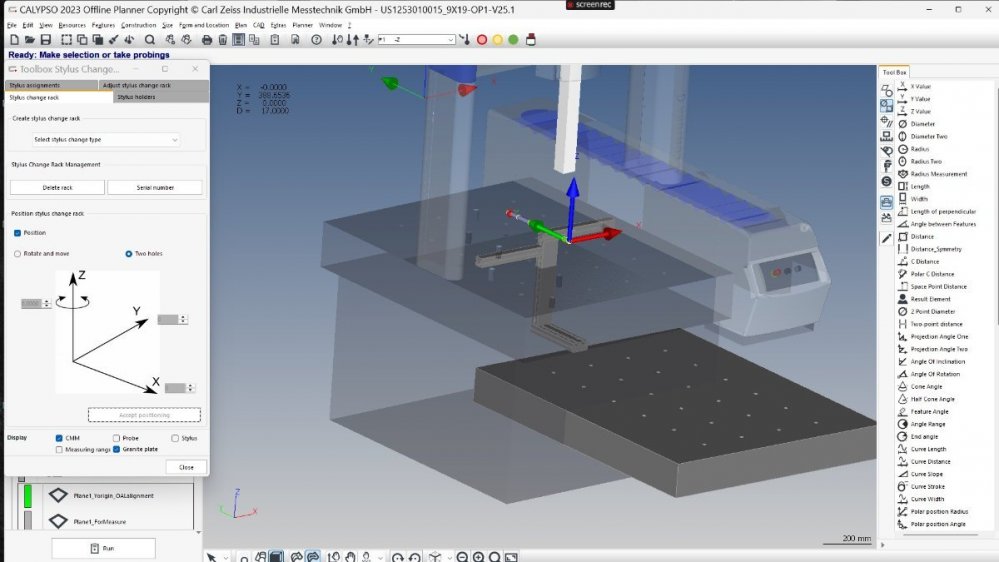

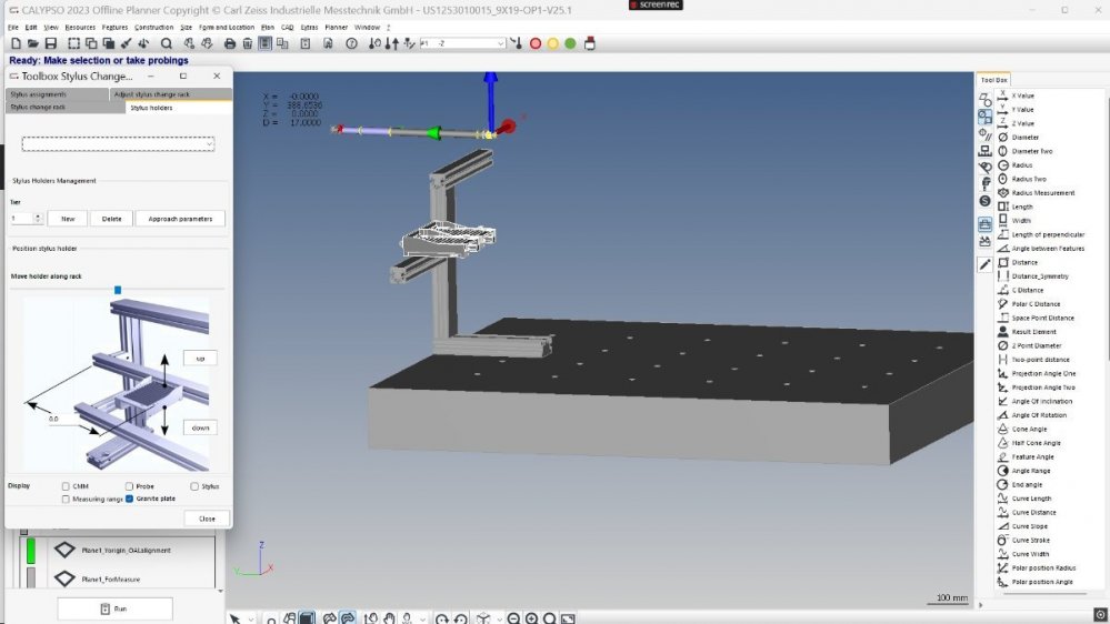

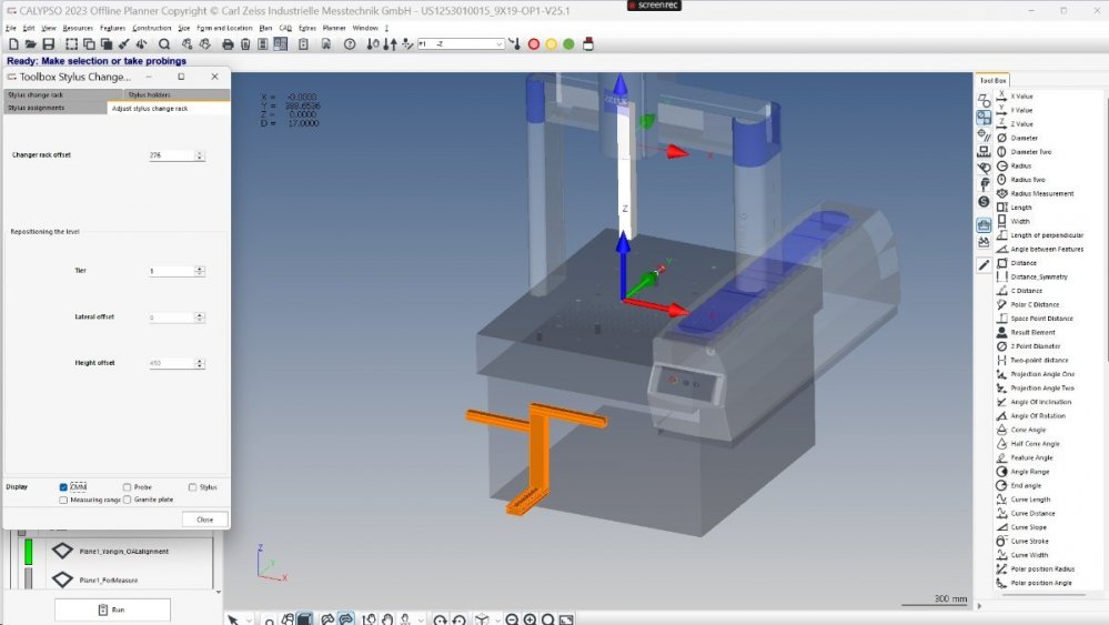

Hey Calypso Community,
Has anyone ever run into an issue where the Toolbox Stylus Change Rack won’t allow proper placement on the granite during setup?
(See attached photos.)
I’m wondering if this might just be a limitation of the preview during the “Set-Up” stage — and maybe it will actually position correctly during runtime after the rack has been saved. I haven’t made it that far yet, so I’m hesitant to proceed without confirming. Ideally, I’d like to correct the position before saving, if that’s even possible.
THIS ISSUE WAS RESOLVED ONCE I REMOVED THE EXISTING CAD (FOR PART PROG.) OFF TABLE, AND THEN RE-LOADED THE STYLUS RACK CREATOR.

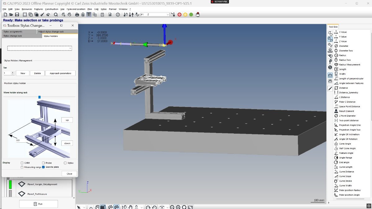

We’ve got an MSRmini, but I haven’t seen anything among the available options in Calypso that actually matches its width. Strangely, I can’t even find the rack listed anywhere on ZEISS’ website — so I have no idea where our company sourced it from.
There is a rack in the Planner default options that looks somewhat similar to our holder, but like I mentioned, I can’t find a way to snap XXT probe sockets to it — and on top of that, the dimensions are off. It’s just not the right width.
Also, does anyone know where I might find additional .xml files to use as the rack's CAD model? Or are there any repositories of user-created or lesser-known options that Calypso can read?
And regarding the XXT probe sockets — I don’t see any options to add individual socket holders. Is it even possible to add those in Calypso? Or are we limited to full stylus system or sensor holders? (I might be off on the ZEISS terminology — I’m referring to the XXT head and its corresponding stylus setup.)
